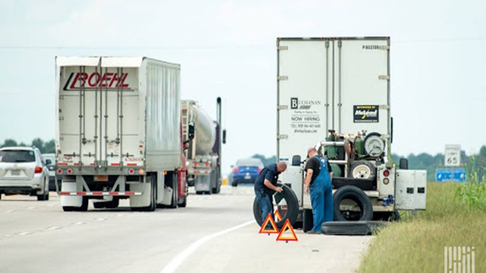

Tire wear is your truck’s way of talking back to you. Feathering, cupping, and shoulder wear aren’t random—they’re signals pointing to alignment issues, suspension problems, or driving habits that need attention. Learning to read tire wear like a mechanic saves you money, keeps CSA points off your record, and extends the life of your equipment.
(Photo: Jim Allen/FreightWaves. Tire wear patterns are a free diagnostic tool. Feathering points to alignment, cupping hints at shocks or suspension, and shoulder wear often ties back to inflation or load balance. Reading them right means catching problems before they cost you.)
