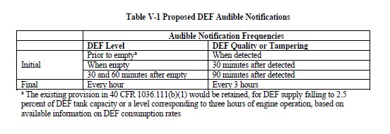

  • The elimination of deratements, where an engine suddenly slows or stops if its emissions systems are signaling an issue with their operations. The deratement would be replaced with a visual or audible warning that a truck’s emission systems are failing in some regard, including a lack of diesel exhaust fluid (DEF) in the system. Deratement is a function of what the EPA calls “inducements,” processes that seek to ensure the operator of a diesel vehicle is properly using DEF through a selective catalyst reduction (SCR) system.

Zeldin’s EPA already had moved on the issue of deratements in March when it eliminated a rule that a  truck maintain a diesel exhaust fluid (DEF) sensor that would report problems in the system or that supplies in the DEF tank were running low.
But the way the sensor would report the problems would be to slow or stop the vehicle.
The NPRM is recommending a 90-second audible warning that the DEF system is running low on fluid or has been tampered with. The fix might be as simple as filling the DEF tank, the EPA said. And that won’t be a problem. “It should not require much time to find and refill DEF to resolve the audible notification,” the EPA said.
