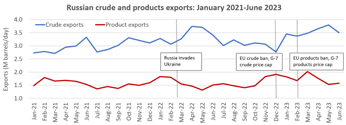

New data from Kpler confirms the ongoing strength in Russian export volumes. “The fact is that Russia continues to find downstream markets for its crude and products despite sanctions,” Reid I’Anson, senior commodity analyst at Kpler, told FreightWaves.
Russian crude exports rose to 3.8 million barrels per (b/d) day in May, the highest level since before the pandemic. June crude exports averaged 3.5 million b/d through Monday, down from May but still 15% higher than the average in the 12 months prior to the invasion of Ukraine.
The vast majority of Russian crude is flowing to China and India, with smaller volumes to Turkey and Bulgaria, said I’Anson.
Russian petroleum products exports are averaging 1.6 million b/d so far this month, according to Kpler data. That’s down from the record high of 2 million b/d in March, but still in line with pre-invasion volumes despite a boycott by the EU, formerly Russia’s largest buyer.
“Flows [of Russian refined products] to Brazil have picked up considerably alongside flows to the Middle East and North and West Africa,” said I’Anson.

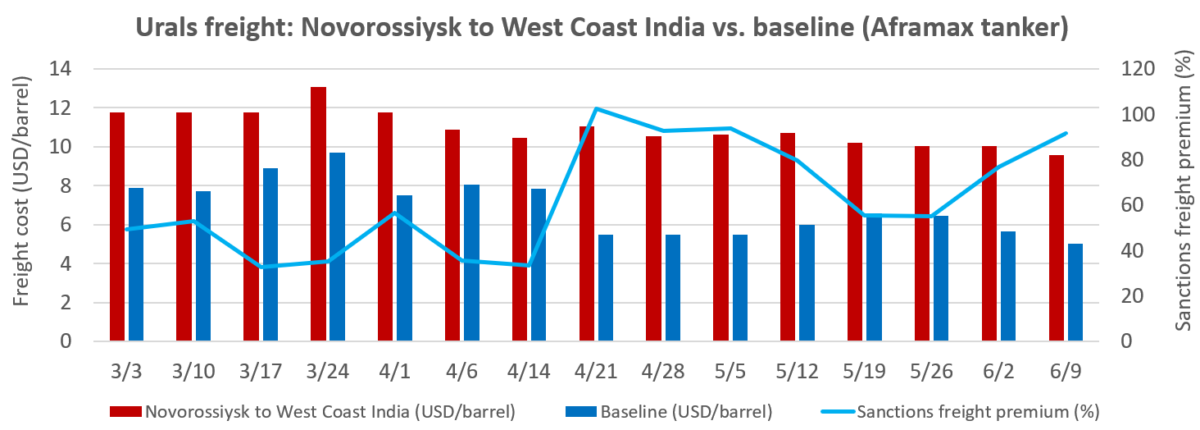

For an 80,000-ton cargo of Russian Urals loaded in Novorossiysk aboard an Aframax-class tanker and shipped to the west coast of India, Argus data shows that freight averaged $3.43 per barrel more or 42% higher than the baseline rate between early March and mid-April.
During the eight weeks from April 21 through Friday, the premium earned on this Russian route soared much higher, averaging $4.59 per barrel more or 81% above the baseline.
In the most recent week, Aframax owners carrying Russian cargo on this route earned a 92% “sanctions premium,” according to Argus data.

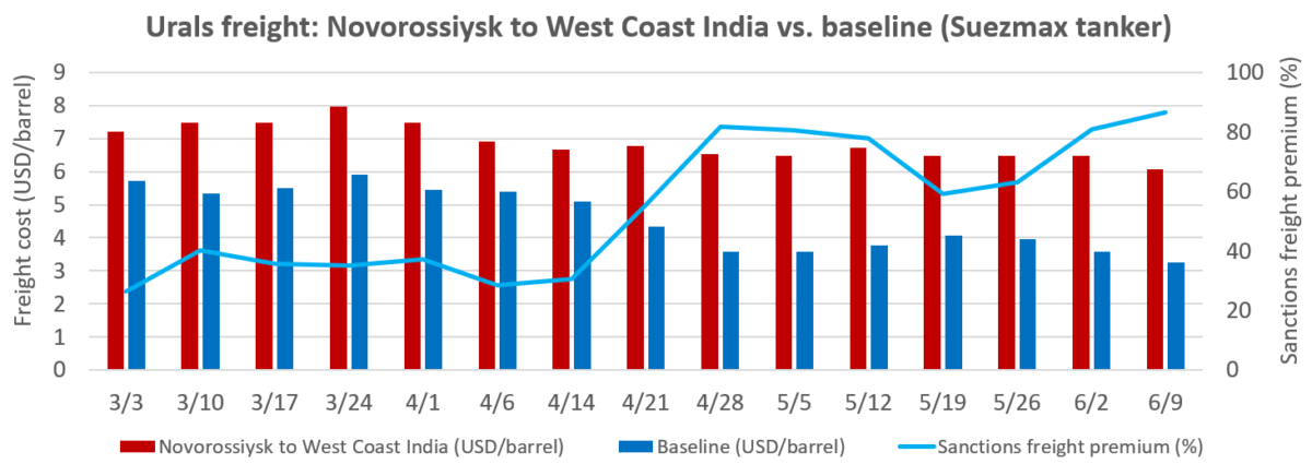

The same pattern is seen for larger Suezmax-class tankers loading 140,000-ton cargoes in Novorossiysk for delivery to the west coast of India. Argus data shows an average 33% premium versus the baseline for the weeks from March 3 to April 14, rising to an average 73% premium from April 21 to the week ending Friday as a result of the falling baseline rate.

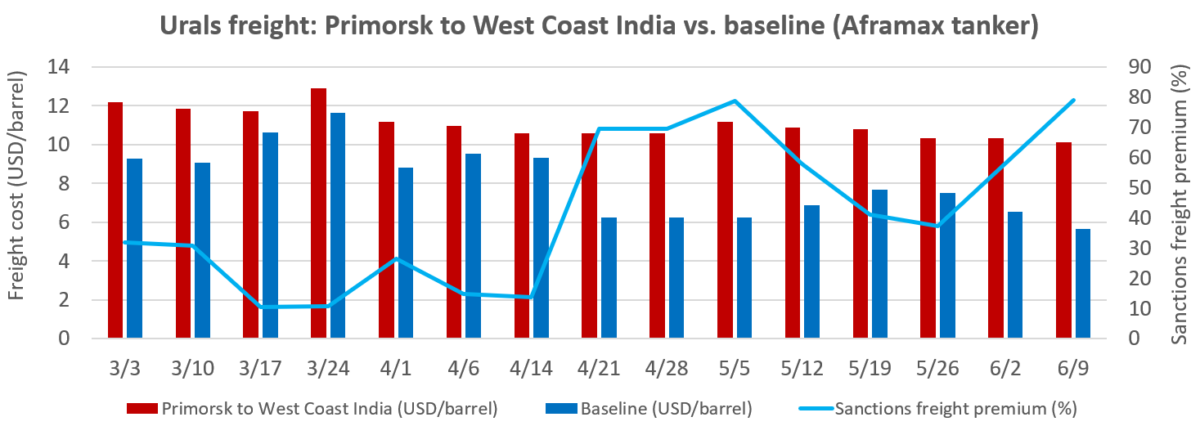

Aframaxes loading 100,000-ton cargoes at Primorsk in the Baltic Sea for delivery to India’s west coast earned an average premium of $1.87 per barrel, 20% above the baseline, between early March and mid-April.
Then average premium shot up $3.98 per barrel, 61% above the baseline, in the weeks since then, according to Argus data. The Primorsk-India rate was 78% above the baseline rate in the most recent week.
The initial rise in the Russian freight premium coincided with the pullback in cargo interest from mainstream operators worried about the price cap in April. But the return of these mainstream tankers to the Russian market since then has not brought the premium back down.
“Freight rates have not dropped as shipowners insist on repeating the last-done levels and are not lowering their offers,” said Mitchell and Ollett. “Rates have balanced at their current levels and are not, for the moment, responding to shifts in the regular [non-Russian] spot market.”
