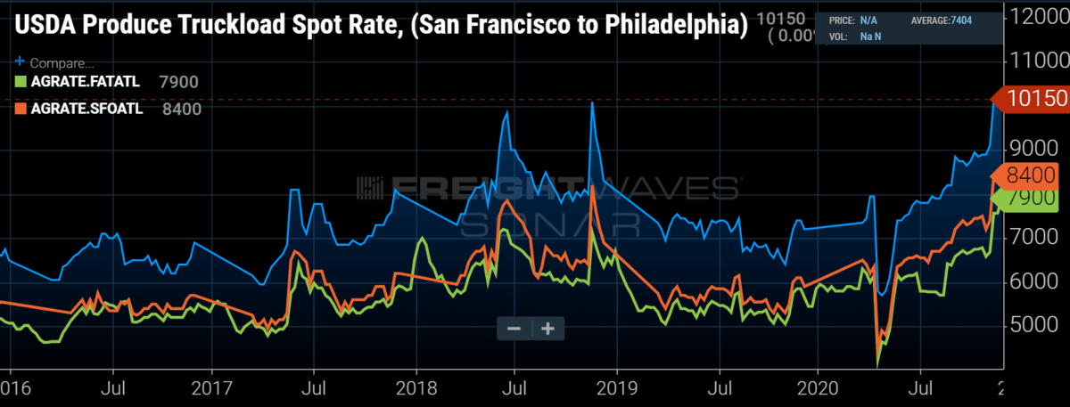

Chart of the Week:  USDA Produce Truckload Spot Rate – San Francisco to Philadelphia, Fresno to Atlanta, San Francisco to Atlanta SONAR: AGRATE.SFOPHL, AGRATE.FATATL, AGRATE.SFOATL

The average rate for moving a produce load from the Salinas Valley in Northern California to Philadelphia has risen from $7,550 in mid-June — the typical average late-spring peak — to $10,150 at the end of November. Not all of this increase came at once either.
Potentially more unusual than the rate differential is the steady trend line between the two values. Typically, the spot rates recede after the spring/summer peak before rising later in the year. The average spot rate for Northern California loads did not have more than one week of decline sequentially from June till the end of November, an indication that general market tightness was driving the rate increase.

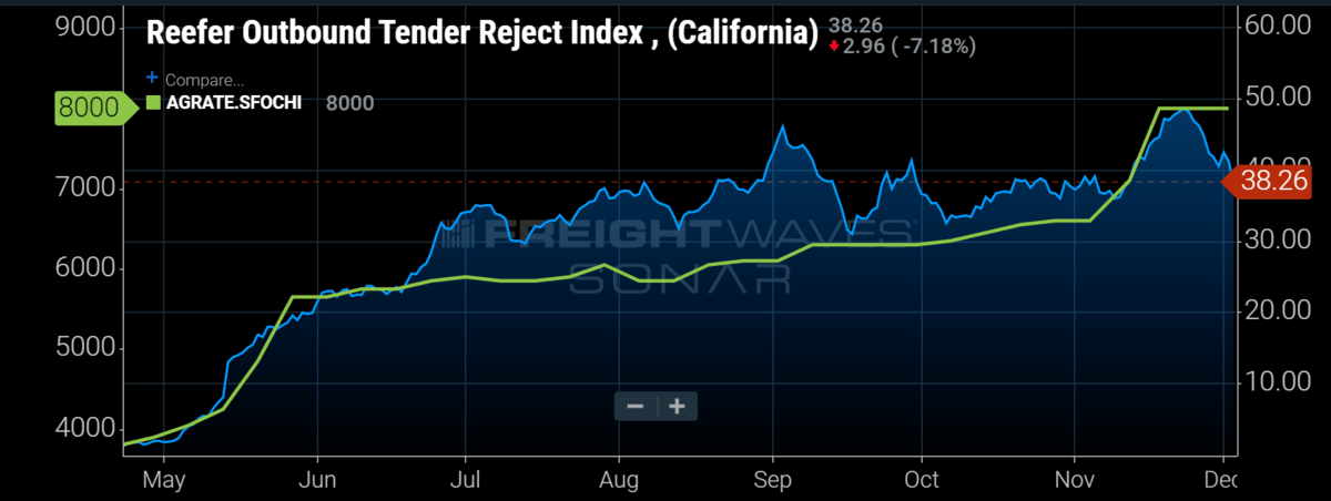

Reefer tender rejection rates have a strong connection to spot rate movements, suggesting rates should contract a bit after this week. Chart: SONAR – ROTRI.CA, AGRATE.SFOCHI
Looking at the Reefer Outbound Tender Reject Index for California in comparison to the produce truckload spot rates, it appears there will be reduced pressure on rates in the near term — the higher the rejection rate, the higher the likelihood for increasing spot rates. The index shows reefer rejection rates falling from near 50% over Thanksgiving to under 40% this week. This is still an extremely high rate of rejection from carriers, but the sharp decline is an indication carriers have more availability this week, which should pull rates back down a bit.
