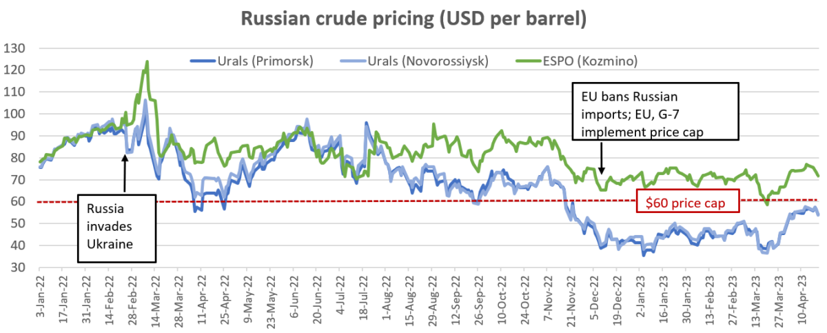

According to price assessments by Argus, ESPO crude out of Kozmino is well above the cap and has been so since the beginning of sanctions. ESPO closed Thursday at $71.56 per barrel (based on the “free on board” or FOB price, which excludes shipping costs).
Now, the price of Urals is getting uncomfortably close to the cap. It is trading at a 35% discount to Brent, but as Brent rises in the wake of OPEC cuts and rebounding demand, Urals is now within a few dollars of the cap. Urals hit a recent high of $57 per barrel on Tuesday, according to Argus data.
chart showing Russian crude price vs. cap price
Price is on a free-on-board basis. (Chart: FreightWaves based on data from Argus)

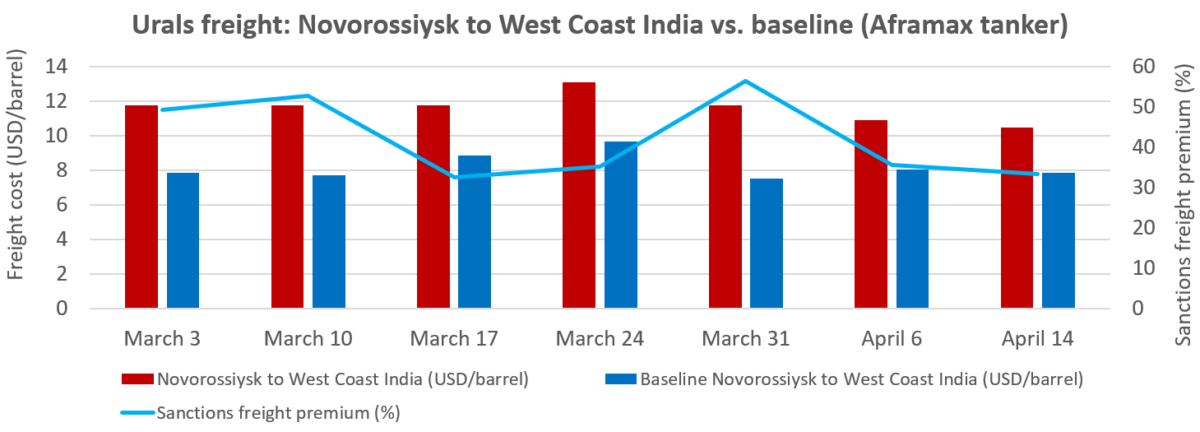

The extent of the “sanctions premium” is the focus of a new freight pricing product introduced by Argus on Wednesday. It assesses average weekly Russian crude freight costs (including both the mainstream and shadow fleets) to China and India versus a non-Russian-cargo benchmark.
To take one example, Argus’ data shows that the freight cost to move Urals from Novorossiysk to the west coast of India aboard an Aframax tanker (with a cargo of 80,000 tons) earned an average of 42% more than a baseline Aframax over the six weeks ending last Friday.
The Russian cargoes earned as much as 57% more in freight in the week ending March 31 in this particular trade. The premium had fallen to 33% in the week ending Friday. The spread, while still high, has narrowed.
chart showing price of Russian export crude freight vs. baseline
Younevitch explained, “With the general fleet now heavily involved, Russian-origin freight is directly influenced by supply and demand fundamentals in the open market.
“So, if there is oversupply and a weak market for Aframaxes and Suezmaxes in the Atlantic [Suezmaxes carry around 140,000 tons of crude], this is mirrored in the Russian-origin freight, and the sanction premium gets narrower.”

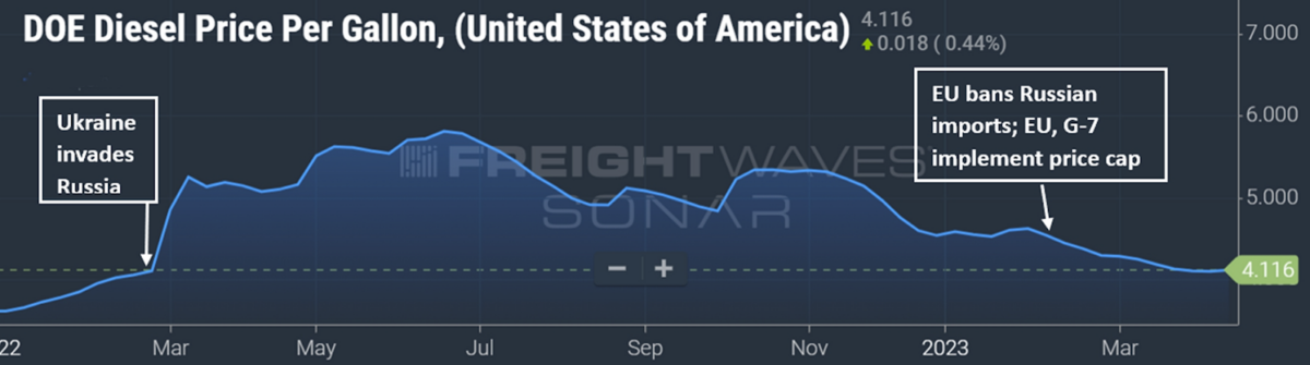

The Department of Energy issues a weekly average for retail diesel, a benchmark used in most trucking surcharges. The latest average, issued Monday, came in at $4.12 a gallon. That’s almost identical to the average in the week immediately prior to Russia’s invasion of Ukraine.
Over the 10 weeks since the EU banned Russian products imports and the G-7 and EU implemented the diesel price cap, the DOE diesel benchmark has dropped 11%. There’s no fallout yet from Western sanctions when you look at the prices at the pump.
(Chart: FreightWaves SONAR)
