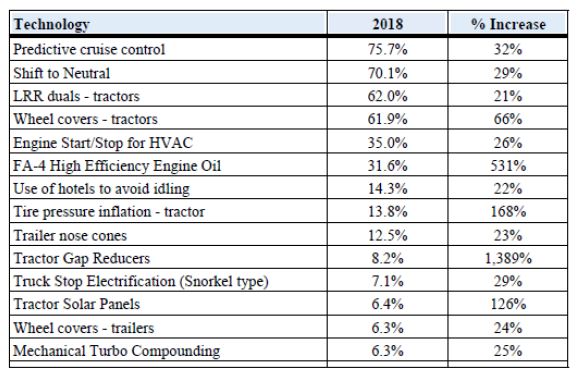

According to the NACFE data, 75.7% of the fleets it surveyed by the end of 2018 had predictive cruise control.
But the technology with the biggest growth in 2018 were tractor gap reducers. Gap reducers fill the space between the tractor and the trailer and reduce the wind drag that open space creates.
According to the NACFE study, by the end of 2018, tractor gap reducers were only on 8.2% of the fleets surveyed. But that marked an increase of 1,839% from a year earlier.
Source: NACFE
Another technology with huge uptake were FA-4 high-efficiency engine oils. In an information sheet published several years ago, Shell said FA-4 oils were “designed primarily for next-generation engines to help maximize fuel economy without sacrificing engine protection.” That would indicate that the increased penetration of FA-4 oils would be expected as old trucks are taken off the road to be replaced by new ones. The penetration at the end of 2018 for FA-4 oils was 31.6%, a jump of 531%, according to NACFE.
Another notable statistic: Tractor solar panels were on 6.4% of the surveyed fleets at the end of 2018. That was a jump of 126%.

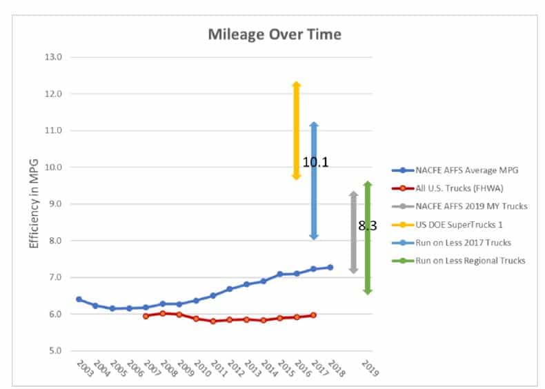

The average annual rate of improvement in fleet miles per gallon in the study, going back 16 years, is 2%. But the increase to 2018 from 2017 for the fleets in the study did not meet that standard. It rose to 7.27 mpg from 7.23 mpg the year before. That’s an increase of about half a percentage point.
The study also has data on the fuel efficiency of the broader population of trucks, beyond those operated by the fleets studied. But it isn’t as up to date as the group in the study; NACFE reported that at the end of 2017, the broader fleet had an average of 5.98 mpg.
NACFE was able to get granular data from companies on how their 2018 model year vehicles operated. The organization did not share this data except on an aggregate basis. But NACFE did say the newer vehicles are generally operating at 7.5 to 9.5 mpg, and “some trucks were even found to deliver 10 mpg in certain routes, conditions and seasons.”
(The Run on Less demonstration in October 2019, testing what the NACFE said were “more demanding regional haul duty cycles, recorded an average of 8.3 mpg. A “best of the best” test in 2017 reached 10.1 mpg.)
