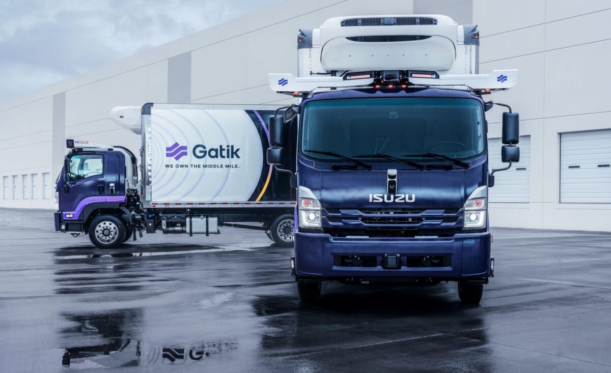

The announcement by Gatik and Isuzu on Tuesday that Isuzu would invest $30 million in Gatik and jointly produce autonomous middle-mile autonomous trucks didn’t go unnoticed by another Gatik investor — Ryder.
Isuzu Motors Ltd. is investing $30 million in Gatik and collaborating on autonomous trucks for 2027. (Photo: Isuzu)

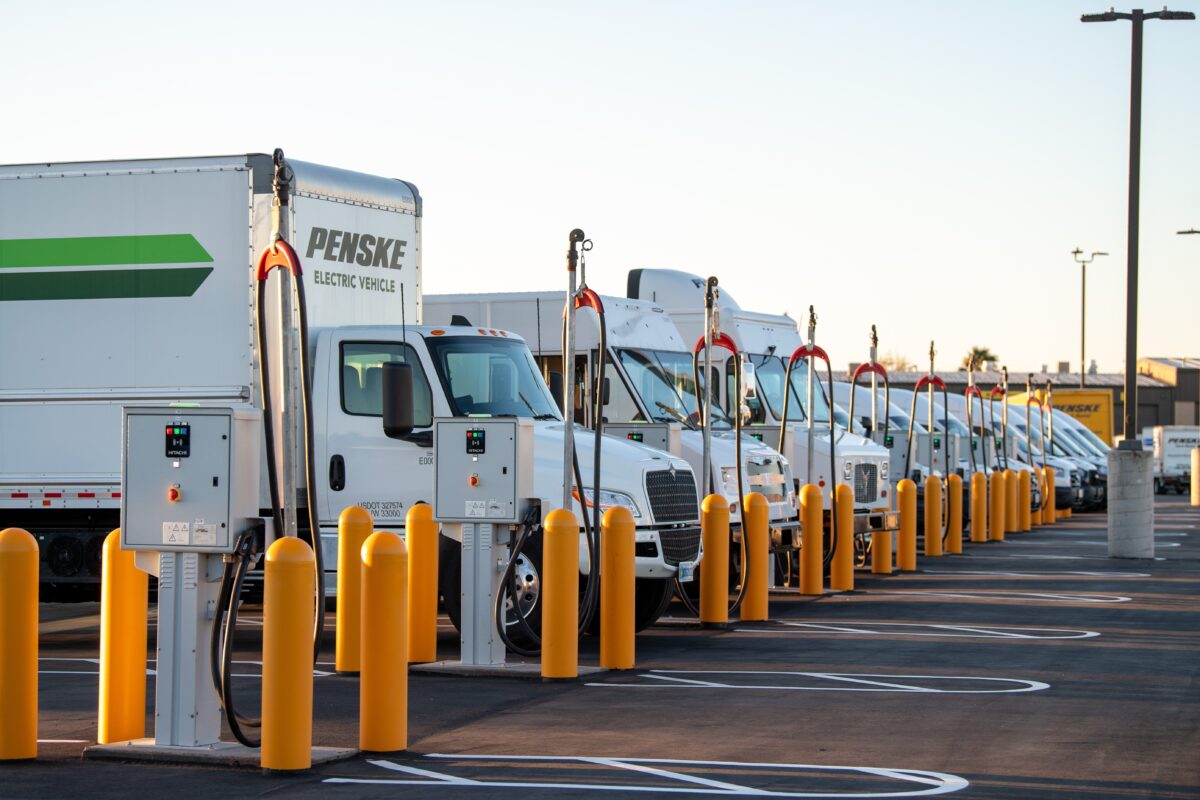

Penske Truck Leasing and its 445,000-vehicle fleet has joined Powering America’s Commercial Transportation, a coalition pressing for more medium- and heavy-duty electric truck infrastructure.
Penske Truck Leasing has joined the Powering America’s Commercial Transportation coalition. (Photo: Penske)
