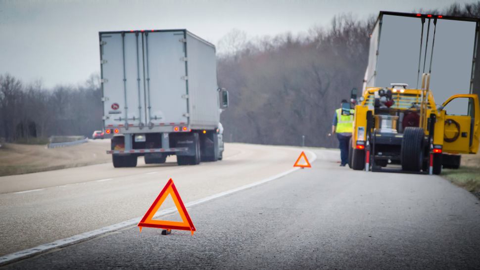

Don’t forget about safety triangles or flares
Now here’s where many drivers fall short: They don’t use, or even have, a set of safety triangles.
“They have to be put out if you’re gonna be sitting there for longer than 10 minutes — that’s the rule,” Runnels said. This raises the question: Do you have a set?
Safety triangles or road flares are perhaps the most important roadside safety equipment because they alert motorists of your situation in advance. Your blinking emergency lights aren’t likely to provide sufficient warning.
But there’s an art to using them.
Runnels said he often comes across scenes where drivers place the triganles 10 feet or so apart, which renders them completely ineffective.
“They’re supposed to be at 10 feet, a hundred feet and then another hundred feet,” he said. But he added that their placement really depends on the road. For example, if the truck is stranded on a curved section of a road, especially on a two-lane road, Runnels suggests putting two triangles behind the trailer and saving the other for upfront.
How you place them is just as important. Runnels finds that many drivers don’t know how to set up the triangles properly.
He instructs drivers to make sure that each edge of the triangle is locked in place and to twist the weighted bottom piece to ensure it doesn’t fall over.
