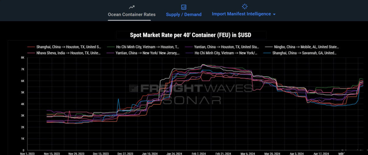

“As per desperateness: Xeneta data shows that the spot market average on key trades like Shanghai-Rotterdam, Ningbo-New York/New Jersey and Shenzhen-Los Angeles ports is going up, almost exclusively because the shippers who are paying more than the average (our Market High) are now paying much more ($900 per FEU) — whereas the larger, non-desperate shippers are only paying a little bit more ($50 in May) than what they did in the second half of April,” explained Sand.

Blank sailings, the major component of this cocktail, are increasing after ocean carriers gorged on higher Red Sea rates while they could with the added capacity. But the window to capitalize on this was short-lived, and spot rates started to drop because of the decrease in freight orders. Spot rates are now rising back as capacity is being cut.

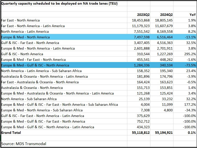

Antonella Teodoro, senior consultant at MDS Transmodal, tells American Shipper it would appear that there are changes in level of capacity offered on the Gulf and Indian subcontinent and Far East trade lanes, as well as on the trans-Atlantic.
Capacity offered on the Europe and Mediterranean-North America route is estimated to contract by more than 13% in the second quarter of 2024 compared with the same quarter last year. The Red Sea crisis diversion and the capacity shuffle as a result on the routes could be the factor to to which this contraction is attributed.
“The globalized nature of the container shipping industry means that local disruptions can be felt globally,” said Teodoro. “We have seen [this] during the peak of congestion experienced by the North American ports a few years ago and we are experiencing this now as well. Differently from 2020-2021, shipping lines now have more capacity at their disposal. However, adjustment in capacity allocation is still required to deal with the re-routing via the Cape of Good Hope. For North America, the trade lane that appears to be suffering is the North America — Europe & Med, expected to see a contraction of more than 13% in 2024Q2 vs 2023Q2.”

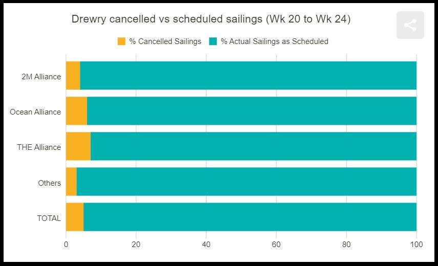

According to Drewry, the alliances have canceled 5% of sailings between week 20 (May 13-19) and week 24 (June 10-16). That’s 32 canceled sailings of 653 scheduled. The biggest loser is the Eastbound route on the trans-Pacific, with 53% of the cancellations. Trans-Atlantic Westbound is down 22%, and Asia to North Europe was slashed by 25%. Leading the charge is THE Alliance followed by the Ocean Alliance.

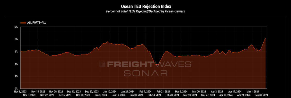

As a result, rejections are up.

“It seems to me that shippers have made a lot of effort to avoid just that,” said Sand. “Still Xeneta expects spot rates on key trades to jump again by mid-May, as carriers have pushed hard to get GRI to stick — successfully at the start of May (in the eyes of the carriers) — giving them appetite for another push. That brings me to ‘defying gravity’ — as something that can’t be done forever. But whereas the spot rates peaked in mid-Jan on main Europe-bound trades and early-Feb on main North America bound trades, they have been falling gradually ever since — until April was fairly flat, and May now sees rising rates.”
