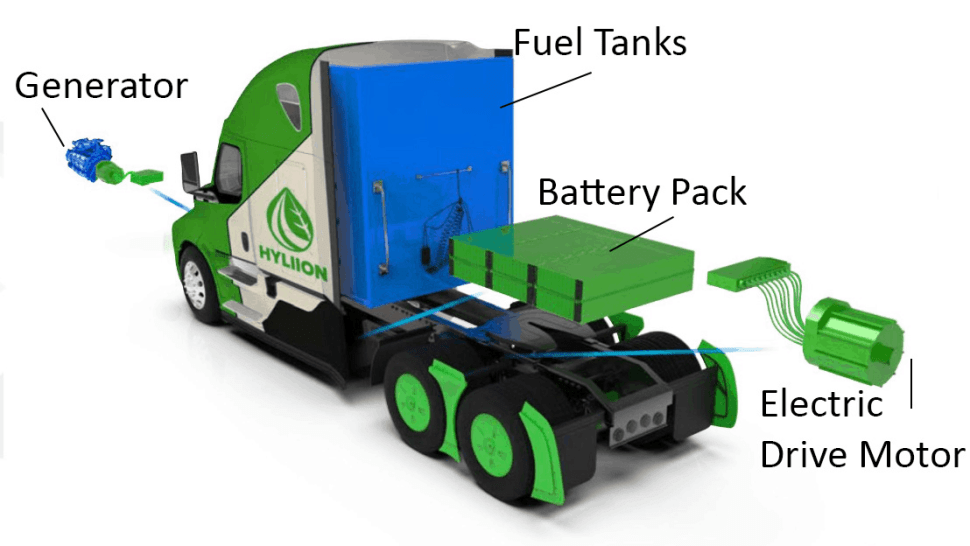

The Hyliion ERX Hypertruck uses a renewable natural gas-fueled generalor to create onboard electricity for the battery pack. (Image: Hyliion)
Hybrid electric powertrain maker Hyliion Inc. is working on a hydrogen fuel cell version of its Class 8 ERX Hypertruck. But don’t be confused. The long-term plan still calls for a renewable natural gas-powered generator to make electricity on board, according to CEO Thomas Healy.

In an interview with FreightWaves, also on Aug. 31, Healy said RNG is a “here and now” fuel that relies neither on invention nor a source of electricity to make it.
“Renewable natural gas makes a ton of sense, and the costs are just so much lower than diesel and of hydrogen, so I’m long on renewable natural gas,” he said.
But it is open to multiple ways to make the electricity for the ERX driveline system that goes into production in 2022. One fleet customer wants a hydrogen-powered fuel cell version. So, Hyliion is partnering with French automotive fuel cell systems maker Faurecia and Symbio, a joint venture of Faurecia and Michelin, for fuel cell technology and production.
“It’s not going to be our primary path,” Healy said. “But it’s very doable.”
“The thing I still can’t wrap my head around is the cost. If hydrogen prices come down and if stations become available, then hydrogen makes a lot of sense,” Healy said. “We’ll be able to take our Hypertruck power platform and slide a hydrogen fuel cell into it” instead of the natural gas generator.
