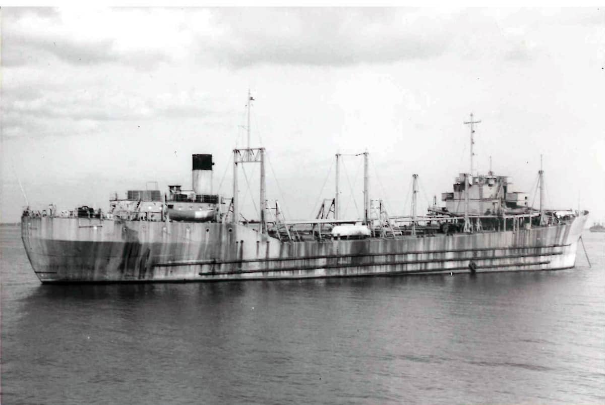

In 1942, a shipyard at Hookers Point in Tampa, Florida, was tasked by the U.S. government to build 24 concrete dry-bulk ships to transport sugar. These vessels, with their six cargo holds, measured 350 feet in length, 54 feet in beam and 35 feet in depth. Their concrete sides were 6.5 inches thick with four layers of reinforcing steel. The ships were easily identified by three rows of wooden fenders on their sides.
All 24 of these concrete ships bore the names of prominent individuals of the cement industry. The first of the fleet was the David O. Saylor, which was delivered in November1942 to Lykes Bros. Steamship Co. of New Orleans.
The remaining ships, although owned by the U.S. government, were operated by other commercial steamship companies for a period before being acquired by the Army for use as store ships or training ships in the South Pacific during the war.

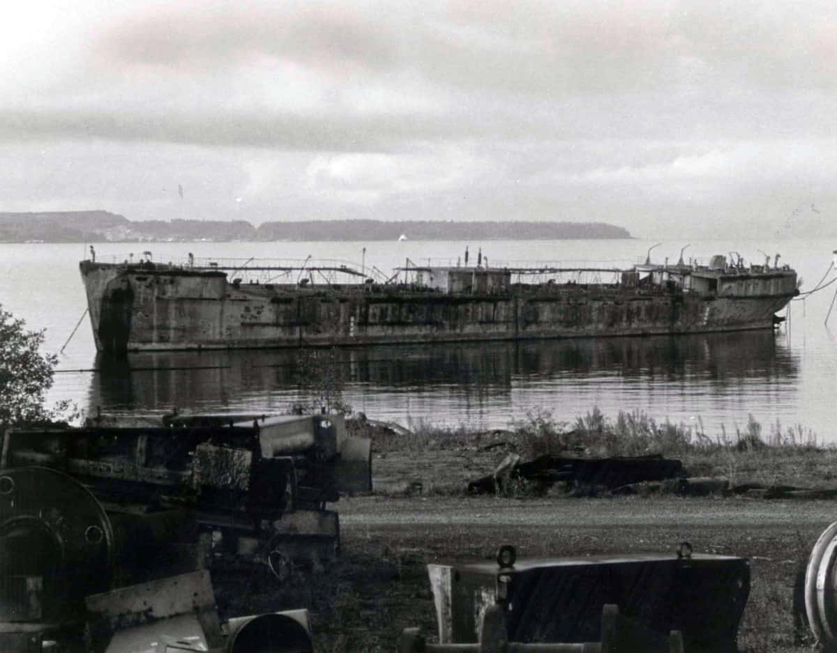

By 1950, all 24 concrete ships were either scrapped or sunk as breakwaters at Kiptopeke, Virginia; Newport, Oregon; and Powell River, Canada.
