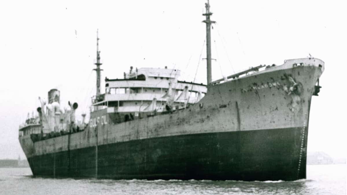

The "jumboized" Gulfbeaver steams proudly down the Chesapeake Bay in 1957. (Photo source: Capt. James McNamara)

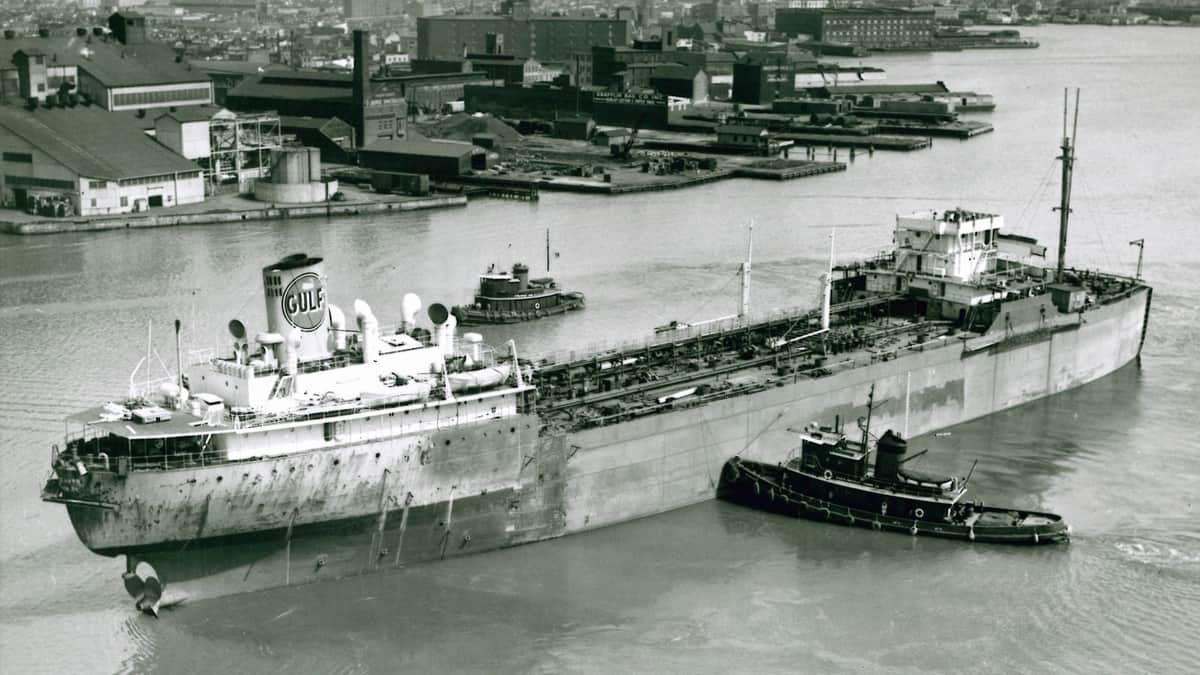

The T-2 tanker Gulfmeadows arrived at the Bethlehem Key Highway shipyard in Baltimore for enlargement in 1957. (Photo source: Capt. James McNamara)
The first T-2 tanker to be jumboized was the Gulfmeadows of the Gulf Oil Co. in early 1957. This work was done at the Key Highway yard of Bethlehem Steel in Baltimore. The new 354-foot-long cargo midsection was built at the nearby Sparrows Point Shipyard. The new midbody increased the beam of the ship seven feet, its length to 572 feet and its deadweight to 20,168 long tons. Although it took 114 days to build the midsection, the actual conversion of the ship took only 36 days. The original midship deck house was welded to the new midbody and the ship was renamed Gulfbeaver. The old midbody was then converted to a barge.

The stern of the Gulfmeadows is married to its new mid-body with the old midship deckhouse in place. (Photo source: Capt. James McNamara)
