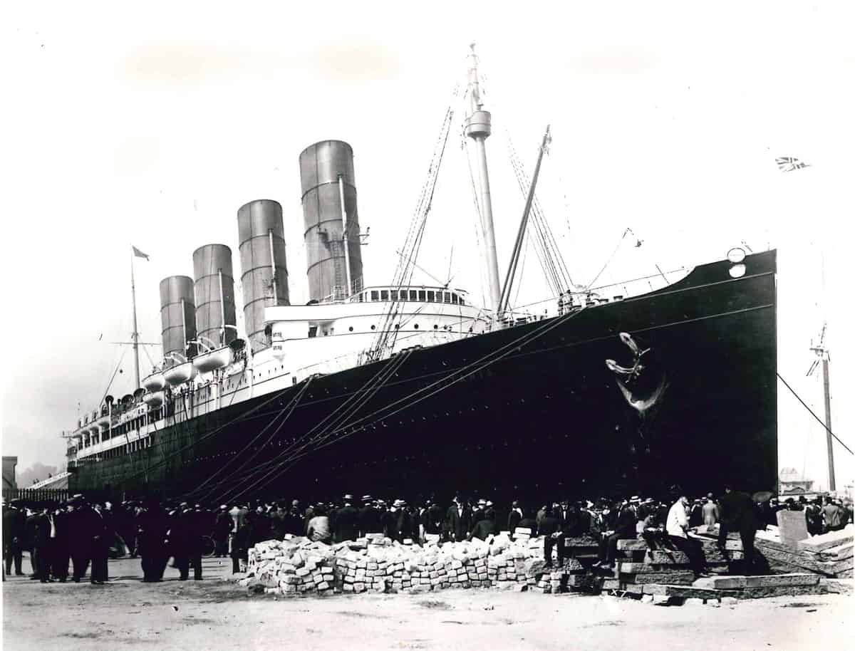

It is unknown if mis-declared cargo caused the explosion that sealed the fate of the Lusitania and 1,198 lives.
The next disaster to catch the eye of the public was the sinking of the Lusitania on May 7, 1915, by a German submarine, resulting in the loss of 1,198 passengers and crew. To this day the nature of the Lusitania’s cargo and its impact on this disaster are still being debated. After the initial torpedo struck the ship, there was a terrific explosion that caused the greatest loss of life. In the ship’s cargo holds were tons of foodstuffs, ammunition, empty shrapnel shells, fuses and other cases and barrels of cargo that had a manifest value of $750,000. The question remains, what caused the explosion — coal dust or the cargo?

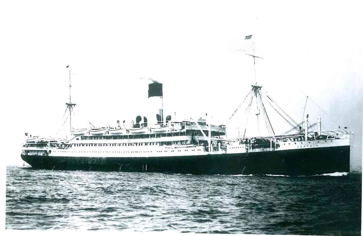

Improperly secured heavy cargo created a severe list, resulting in the loss of the Vestris and 111 lives in 1928.
Years passed until the public was once again shocked by another major sea disaster. The New York Times reported in mid-November 1928 the sinking of the British liner Vestris with the headline, “THE GRIMMEST EPIC of the SEAS since the LUSITANIA was Sunk.”
The 496-foot-long Vestris was built in Belfast in 1912 and plied regularly between New York and the east coast of South America. On Nov. 10, 1928, the ship departed New York with 128 passengers and 197 crew. Due to a heavy load of on- and under-deck cargo, the ship was about 7 inches, or 200 tons, over the legal sailing draft and had a pronounced port list. As the ship sailed south, a very slow roll was experienced and within a few hours took a permanent 5-degree starboard list. The next day two large waves struck the ship, causing the bunker coal and cargo to shift and break loose, resulting in a 32-degree starboard list. Despite the heavy seas, the captain ordered abandon ship and commenced lowering the lifeboats. Of the 325 people on board, 214 were rescued and 111 drowned.
