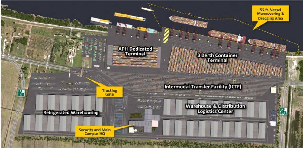

Litrico would not name those partners, but the Plaquemines Port Harbor and Terminal District (PPHTD) has been a vocal supporter and in August announced it had signed a letter of intent to develop a multimodal, state-of-the-art container terminal at the Louisiana port to accommodate the APH vessels.
The proposed terminal at Plaquemines Port will serve as the APH vessels’ homeport. (Image: PPHTD)
“In 10 years, there’s going to be a 10 billion-ton increase in maritime cargo,” Plaquemines Executive Director Sandy Sanders was quoted as saying in a post on the APH website. “If that cargo is going to the Gulf Coast, you need a true gateway port.”
Sanders said the Plaquemines gateway, located at the mouth of the Mississippi, will be able to accommodate a container ship with the capacity to carry 22,000 twenty-foot equivalent units (TEUs) and connect with all modes of transportation to the Midwest. He said the terminal will be like no other in the nation and give beneficial cargo owners optimal options to move their goods.
The entire project is trumpeted as green, with APH saying all its vessels will have clean fuel propulsion. PPHTD said the terminal will operate on electricity, liquefied natural gas (LNG) and compressed natural gas (CNG) and will have the capacity to bunker LNG-powered vessels.
“All existing facilities currently operating in the port jurisdiction utilize private docks and are currently all handling liquids and bulk, not containers,” the PPHTD’s Dale Benoit said. “This will be our first container terminal. Three 22,000-TEU vessels working simultaneously is the planned max capacity; 14,000 TEUs is more like the vessel size initially.”

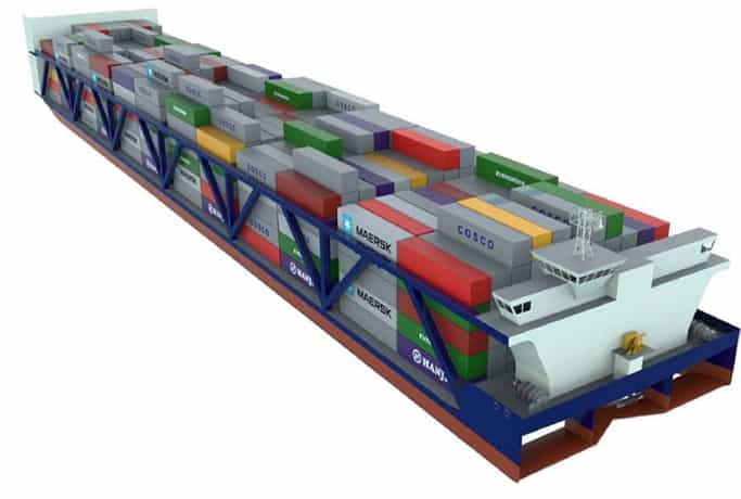

“The liner vessel is our dedicated vessel operating from Plaquemines to Memphis, Plaquemines to St. Louis,” Litrico said. “It will be a dedicated, on-time, scheduled service. It’s the biggest vessel and widest vessel. It’s 595 feet long, 134 feet wide. The only thing that vessel will encounter are very high bridges and that will be from the lower Mississippi all the way to about downtown St. Louis. Our liner vessel can carry up to 2,375 TEUs on a 9-foot draft.
“Our hybrid vessel will have all the efficiency of the liner vessel but smaller and a little bit more nimble because it will operate in the tributary rivers. Tributary rivers have lower bridges and locks and dams. The standard lock and dam throughout the Midwest is 600 feet long and 110 wide. These will be 595 by 100. Thus, they will fit through the locks. The hybrid can carry up to 1,700 TEUs,” he said.
Litrico said the APH vessels will travel “significantly faster” than a barge.
“We have this optimized bow design that basically reduces drag and we can increase our speed. Keep in mind, on the river system today you have a series of barges that are connected together by wires and then there’s a towboat. That towboat is connected by wires to the barges. You have to be very careful when you steer that vessel. You put too much rudder on it, you break those wires. We don’t have any of those issues because we have one composite unit, one big vessel, no pieces to it. A conventional towboat and barge heading upriver against the current, the speed is 4 or 5 miles an hour. Ours is 13 miles an hour — a significant competitive advantage,” he said.
With a speed more than twice that of a barge, the COV service will make a round trip between St. Louis and Plaquemines in 10 days and between Memphis and the Louisiana port in seven days, according to Litrico.
The minimal wake bow is one of two patents APH holds on the new vessels. The other is for the exoskeleton hull structure. The patented features were tested in a 28-foot-long, 6.4-foot-wide model in Germany in the fall of 2017.
