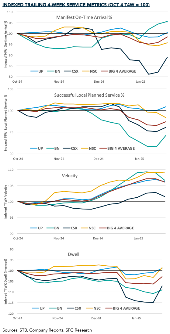

(Chart: Susquehanna)
“Entering 2025, rail service has been far more consistent than the 2021-22 experience aside from some disruption out West as a result from elevated imports (hurting BNSF specifically) and unusual weather in the East (hurricanes & irregular Winter storms having outsized affect on CSX), wrote Susquehanna equity analyst Bascome Majors in a February 5 client note. “All the data supports the story of general service improvement with velocity up across the board from early 4Q levels. In dwell, CSX on a Y/Y basis has significantly lagged peers, but is showing some sequential recoverymore recently. Rails have performed fairly consistently for On-Time Arrival % except CSX who has had notable weakness vs. peers. BNSF since late November has drastically underperformed peers on local service % though is showing some recovery lapping holiday and winter seasonality. In short, this data supports the sound and consistent service at Union Pacific under Vena and the newfound steadiness for NSC under John Orr which should support respective FY25 margin expansion, but we’re watching closely to see how the STB will collect and implement this data practically going forward.”

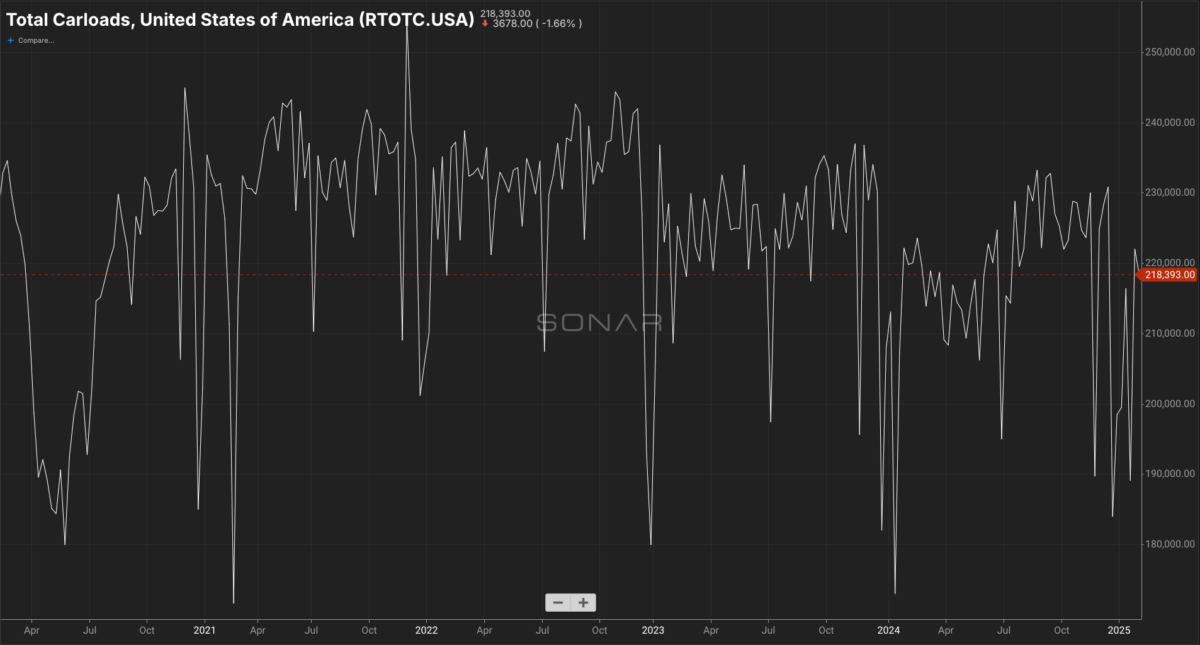

RTOTC measures the total carloads moved by Class I railroads in the U.S. in a given week. (Chart: SONAR. To learn more about SONAR, click here)
