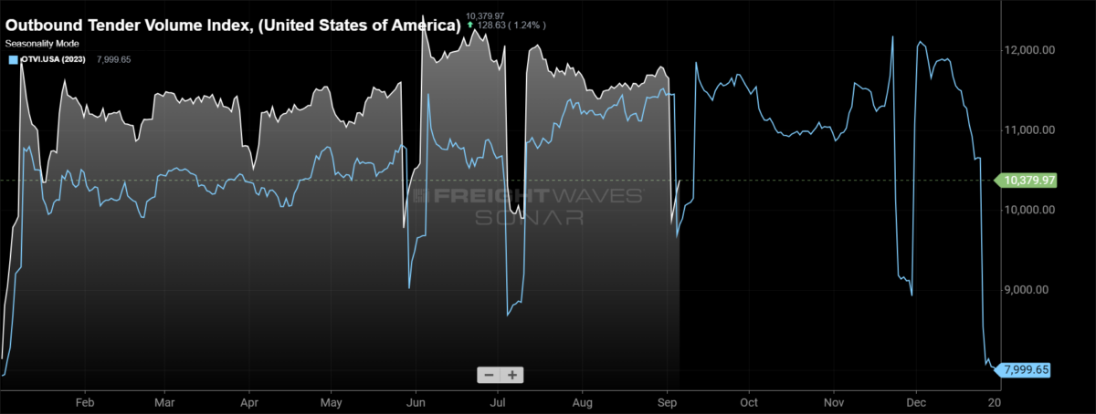

SONAR: Outbound Tender Volume Index — Seasonality View: 2024 (white) and 2023 (blue)
To learn more about FreightWaves SONAR, click here.
The Outbound Tender Volume Index (OTVI), a measure of national freight demand that tracks shippers’ requests for trucking capacity, is down 12.8% week over week, but the reason for that is the Labor Day holiday. The OTVI is a seven-day moving average, and holidays create nuances in the data. Next week, comparing on a two-week stack will provide better insight into how overall freight volumes are moving in September. The OTVI is still 3.57% higher than it was this time last year, which is slightly higher than it was throughout most of August.

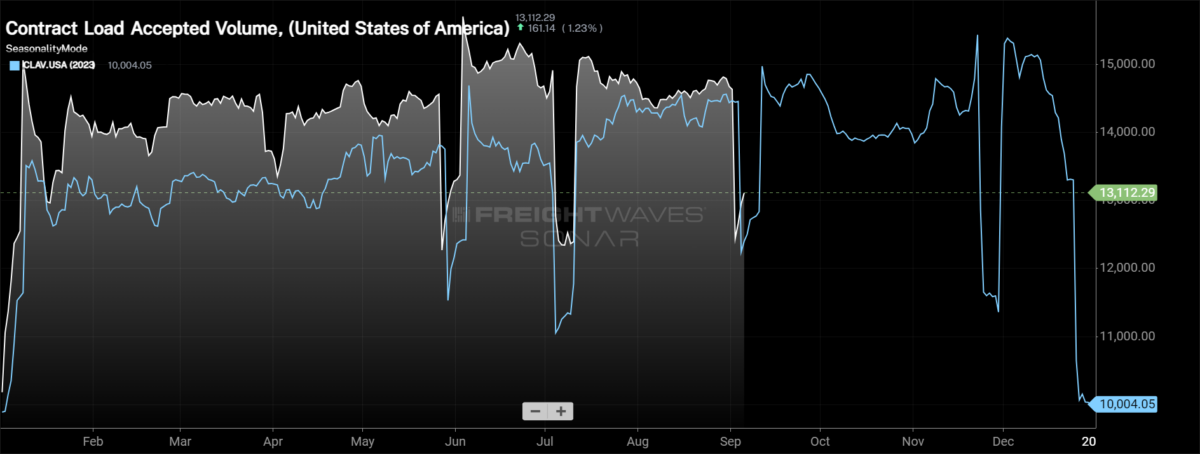

SONAR: Contract Load Accepted Volume – Seasonality View: 2024 (white) and 2023 (blue)
Contract Load Accepted Volume (CLAV) is an index that measures accepted load volumes moving under contracted agreements. In short, it is similar to OTVI but without the rejected tenders. Looking at accepted tender volumes, we see a decrease of 12.31% w/w, again affected by the Labor Day holiday, but the decline isn’t as severe as OTVI because tender rejection rates are lower week over week. Accepted tender volumes are up 3.58% y/y.

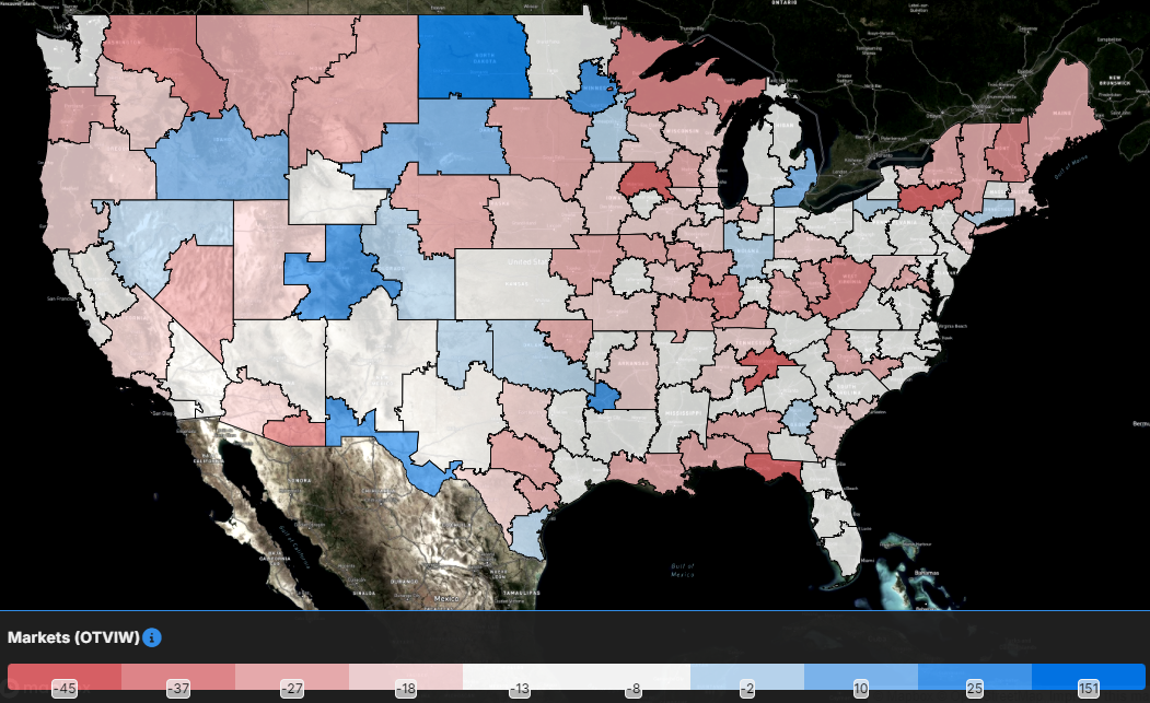

SONAR: Outbound Tender Volume Index – Weekly Change
With the Labor Day holiday impacts weighing on volumes, weekly changes really don’t have a significant meaning to the overall market. That’s evident as 120 of the 135 markets tracked within FreightWaves SONAR experienced lower volumes week over week.
The impacts to volumes in Detroit happened ahead of the holiday, making it the only relatively large market that experienced volume growth over the past week. Volumes in Detroit are up 10.94% w/w, but that has more to do with the timing of holiday volume impacts than true volume growth. Why is that the case? Volumes out of Detroit are 2.23% lower on a two-week stack.
The rest of the increases in volume over the past week stemmed from extremely small markets overall, thus having little impact on the overall market.

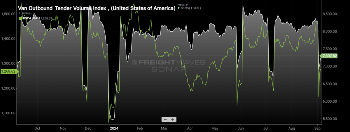

SONAR: Van Outbound Tender Volume Index (white, right axis) and Reefer Outbound Tender Volume Index (green, left axis)
By mode: The dry van market was able to shake off the sluggish start to August and close out the month strong. The Van Outbound Tender Volume Index rose 1.5% throughout August. The comps w/w are challenged because of the holiday, down 12.69%, but y/y they are up 3.32%.
The reefer market saw a nice boost to activity to close out August. The Reefer Outbound Tender Volume Index rose 7.3% during August as the reefer market has continued to recover following a significant slowdown in March and April. Despite the increase through August, reefer volumes are currently down 2.63% y/y.

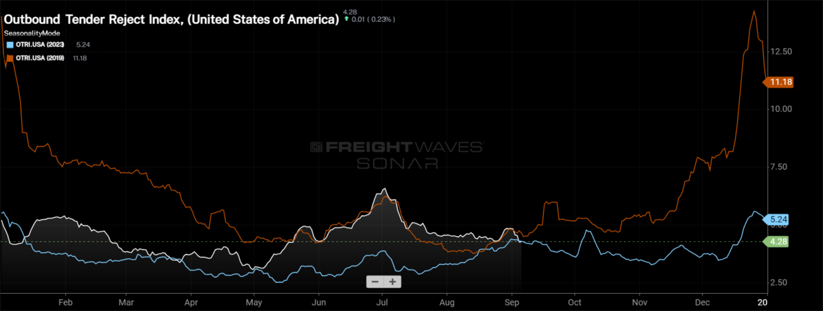

SONAR: Outbound Tender Reject Index – Seasonality View: 2024 (white), 2023 (blue) and 2019 (orange)
To learn more about FreightWaves SONARclick here.
Over the past week, the Outbound Tender Reject Index (OTRI), a measure of relative capacity, fell by 58 basis points to 4.28%, the lowest level since May 19. The OTRI fell below both last year and 2019 levels coming out of the Labor Day holiday, which gives some cause for concern. At present, the OTRI is 3 basis points lower y/y and 38 bps below 2019 levels.

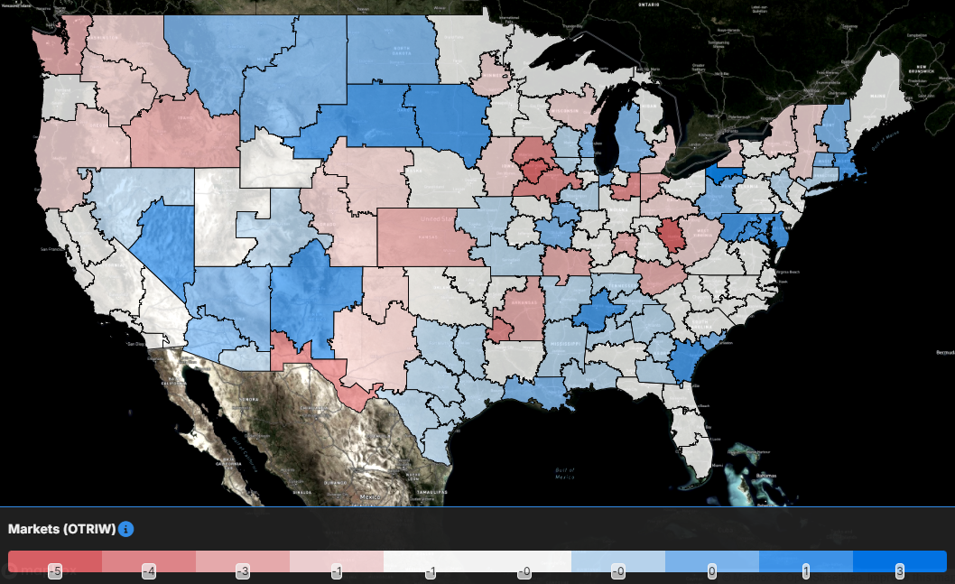

SONAR: Outbound Tender Reject Index – Weekly change
The map above shows the Outbound Tender Reject Index — Weekly Change for the 135 markets across the country. Markets shaded in blue are those where tender rejection rates have increased over the past week, whereas those in red have seen rejection rates decline. The bolder the color, the more significant the change.
Of the 135 markets, 49 reported higher rejection rates over the past week, a decrease from 76 in last week’s report.
The largest increases in rejection rates stemmed from the smaller markets overall, but Savannah, Georgia, did see an increase in rejection rates of 130 bps w/w.
In the largest market in the country, Ontario, California, rejection rates fell by 119 bps week over week to 4.26% as capacity has returned to the West Coast to try to capture some of the volume flowing through the ports of Los Angeles and Long Beach. With the decline, rejection rates in the major Southern California market are now the lowest they have been since May 9.

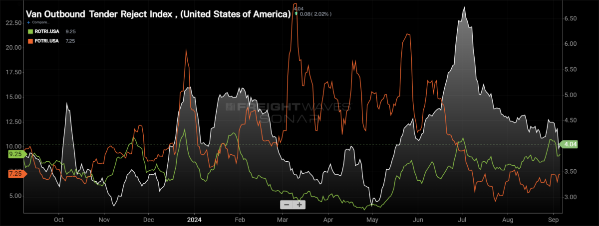

SONAR: Van Outbound Tender Reject Index (white), Reefer Outbound Tender Reject Index (green) and Flatbed Outbound Tender Reject Index (orange)
By mode: The dry van market experienced a sizable drop to kick off September, falling below 4% briefly. The Van Outbound Tender Reject Index fell by 43 basis points over the past week to 4.04%, the lowest level since mid-May. Even with the tough start to September, van tender rejection rates are 24 basis points higher than they were this time last year.
The reefer market has been getting subtly tighter since mid-May as reefer tender rejection rates have been inching higher. The Reefer Outbound Tender Reject Index did fall this week by 148 bps, but it is up 150 bps over the past month to 9.25%. Now, the reefer market typically has rejection rates above 10%, so that is a crucial level for reefer rejection rates in the coming months. At the moment, reefer tender rejection rates are 80 bps higher y/y.
The likelihood of lower interest rates in the coming months has led to a slight increase in flatbed activity. Over the past week, the Flatbed Outbound Tender Reject Index increased by 125 basis points to 7.25%. Flatbed tender rejection rates are up 32 basis points month over month, but the higher interest rate impacts continue to weigh on the market as flatbed rejection rates are 236 bps lower y/y.

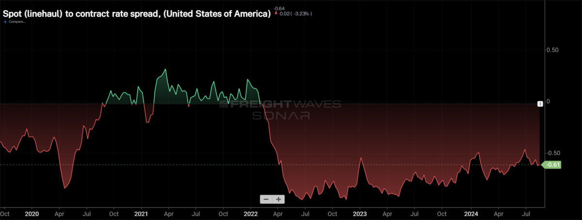

The chart above shows the spread between the NTIL and dry van contract rates is trending back to pre-pandemic levels. The spread widened over the past week as spot rates declined and contract rates rebounded slightly. The spread is now the widest it has been since early June and is still 20 cents wider than it was on average during 2019.

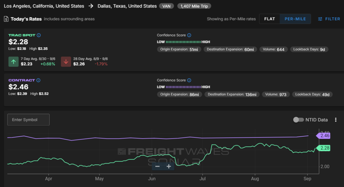

SONAR: FreightWaves TRAC rate from Los Angeles to Dallas.
To learn more about FreightWaves TRAC, click here.
The FreightWaves Trusted Rate Assessment Consortium spot rate from Los Angeles to Dallas erased last week’s decline, rising 4 cents per mile over the past week to $2.28 per mile. At the moment, contract rates are just 18 cents per mile higher than the FreightWaves TRAC rate along this lane.
