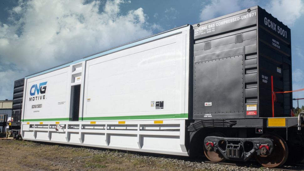

Compressed natural gas tender (Photo: CNGmotive)

Launched in 2015, CNGmotive designed a composite fiberglass tank that is lightweight but still robust enough to hold significant amounts of compressed natural gas (CNG), Santos said.
Conventional tenders can hold less than 2,500 gallons of diesel equivalent, and it takes more than 90 minutes to fill them, according to CNGmotive’s website. CNGmotive’s CNG tenders can be filled with 5,000 gallons of diesel equivalent in under 45 minutes, and the company has a design for a tender that can hold 9,000 gallons, according to Scott.
The Frankfort, Illinois-based company’s specialized tenders store natural gas at high pressure, let the pressure down using industrial-size equipment and deliver it to the locomotive at a constant pressure. Scott said that locomotives with the ability to run on any type of natural gas can use this CNG tender.
In terms of safety, Santos said the company’s tender has a protective structure to survive serious train accidents, and it has even been used as a standard for alternative fuel tenders.
“The combination of being able to do high-density natural gas and composites with the protective safety systems is what enables CNGmotive to deliver a safe solution with CNG, which by itself is the lowest-emissions and lowest-cost method of transporting gas for a locomotive,” Santos said.
