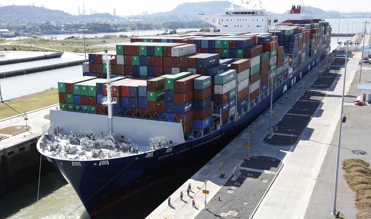

The new workhorse
“Some are 13,000 TEU but most are 15,000-15,900 TEU. We can now see that these ships are going to be the workhorses of the sector, comparable to the maxi-Panamax [up to 5,100 TEU] ships that went through the old Panama locks.
“Carriers are asking: What is the ideal ship of the future, versatile enough to be used in a lot of trades? The answer, mostly, is the biggest ship possible to transit the Panama Canal.”
more newbuild orders for neo-Panamaxes
The 14,414-TEU neo-Panamax CMA CGM Theodore Roosevelt, an example of ‘the new workhorse’ (Photo: Panama Canal Authority)
In the larger categories, owners are ordering either megamaxes or neo-Panamaxes, “but nothing in between,” he continued. “Nobody is ordering 18,000-TEU ships. And I strongly feel that nothing will be ordered [in this size], simply because it doesn’t make sense.
“You will have ships in Far East-Europe and you’ll want the biggest ships — 24,000 TEUs. Or you’ll want the flexibility and you’ll go for 15,000-15,900 TEUs, which you can deploy on virtually all trades.
“You can put them in the trans-Pacific via Panama, on Asia-Latin American, on Asia-West Africa. There is even a 15,000-TEU ship now going from India to the U.S. East Coast.”

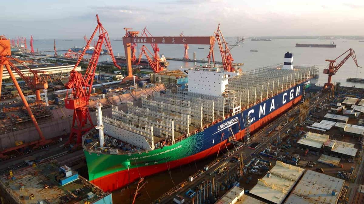

LNG newbuild order
CMA CGM LNG-powered newbuild (Photo: CMA CGM)
“All the others are scrubber-fitted,” he said.

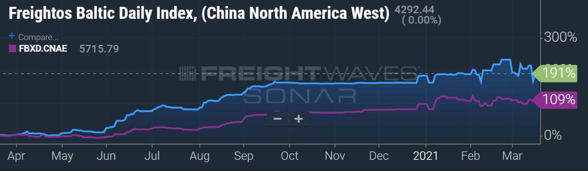

Fearnleys Securities estimates that global volumes will increase 6% this year, while capacity will only increase 3%. Alphaliner net expects fleet growth of 3.7%. Clearly, this supply-demand outlook offers no relief from historically elevated spot rates.
As of Thursday, Asia-West Coast spot rates (SONAR: FBXD.CNAW) were at $4,292 per forty-foot equivalent unit (FEU), up 191% year-on-year, according to the Freightos Baltic Daily Index. Asia-East Coast rates (SONAR: FBXD.CNAW) were $5,716 per FEU, up 109% year-on-year.
(Chart: FreightWaves SONAR. To learn more about FreightWaves SONAR, click here.)
The longer-term question for cargo shippers is whether larger fleets will compel liners to go for market share and compete more on price, i.e., whether liners’ current capacity-management discipline will ultimately break down.
