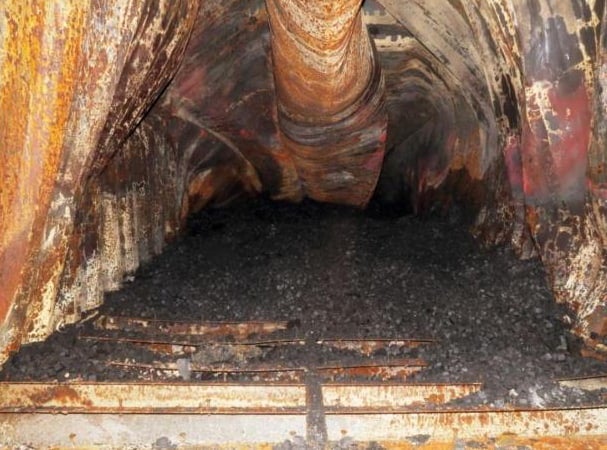

The chief officer, a 29-year-old German, and a small group ventured onto the deck the next morning. “A large number of charcoal cubes was found in the transverse corridor between bays 12 and 16. These also glowed beneath the containers on the starboard side of bay 12. No smoke could be seen coming out of the containers in bay 8. The chief officer stated that at that point there were still five full cylinders of compressed air available out of 35 originally,” the BSU said.

The floor of the container at slot 120382 was completely burned. (Photo: BSU)

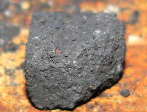

Page 46 of the BSU report states, “Coconut charcoal rather than the coconut pellets specified in the cargo documents was in container UACU5272502 at slot 120782. The difference between coconut pellets and the pyrochar … is clear. Coconut pellets are produced by grinding coconut shells and used as fuel for furnaces. … Chemically, coconut pellets are completely different from coconut charcoal.
Coconut charcoal cubes were found. (Photo: BSU)
“Pyrochar or vegetable char, produced by means of coconut shell pyrolysis, have properties comparable to wood-based charcoal,” it said.
