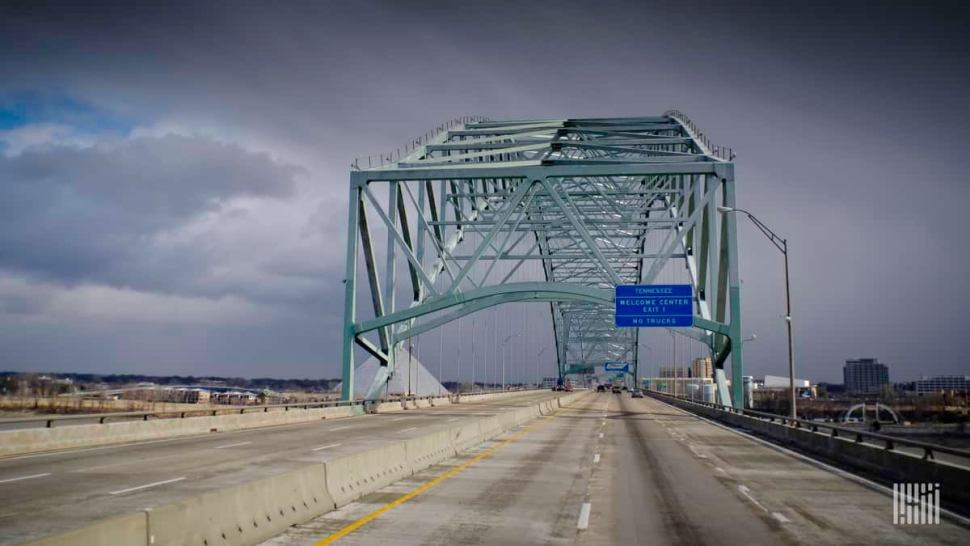

During a May 11 routine inspection of the bridge, an Arkansas Department of Transportation (ARDOT) engineer spotted a fractured beam.

Damage to Interstate 40 bridge between Memphis and eastern Arkansas. Top photo is from May 2019; bottom is from May 2021. (Photos: ARDOT)
