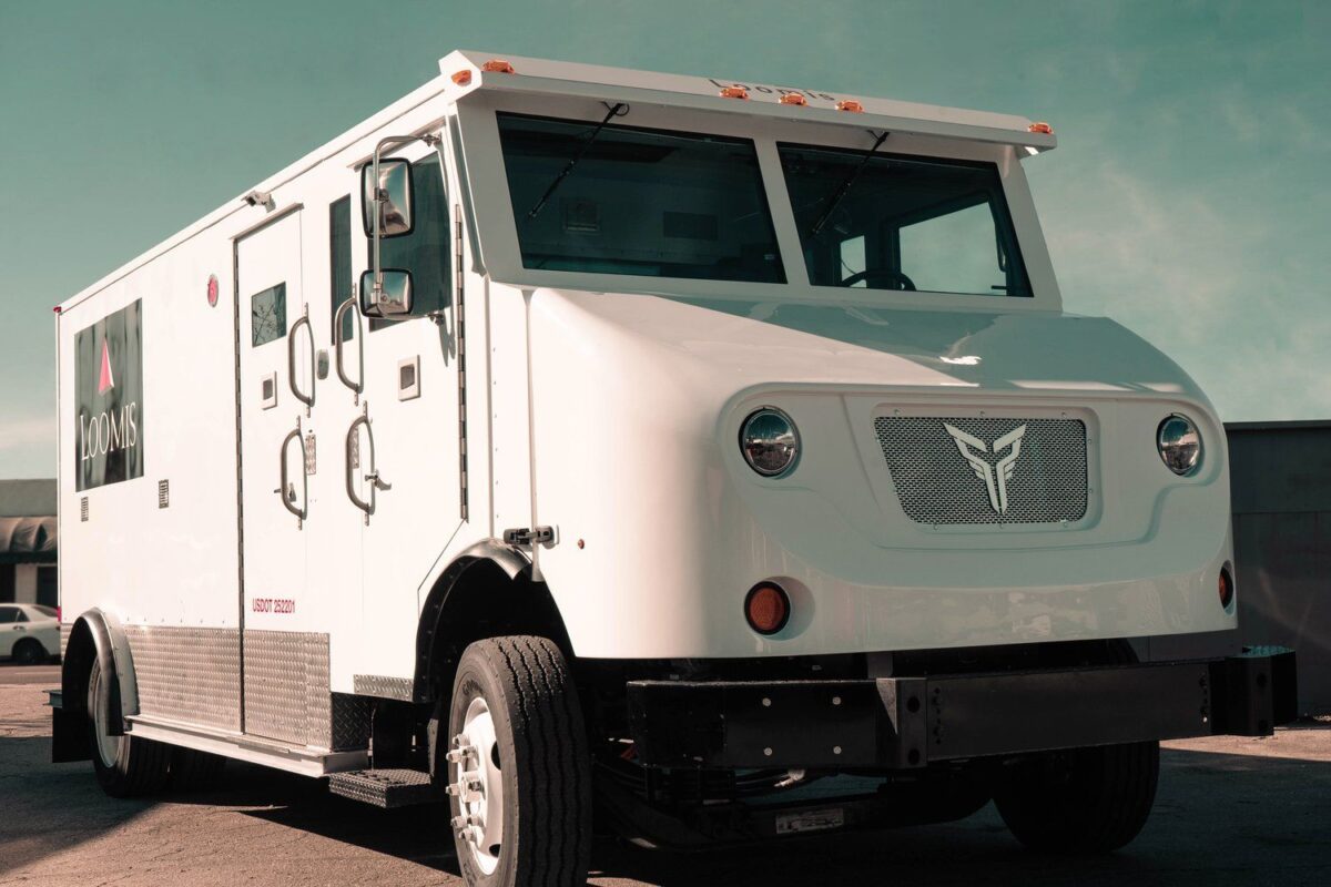

Loomis was among the first fleet customers for Xos Trucks. (Photo: Xos)
