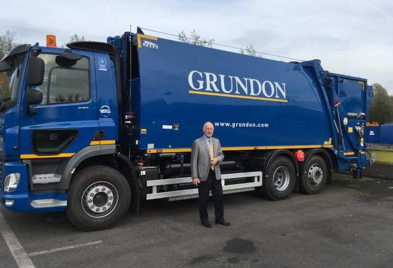

The Grundon system is a hydrogen-fueling system that is retrofitted onto a DAF truck. It is a dual-fuel system, allowing the truck to operate on diesel fuel when hydrogen is not available.
