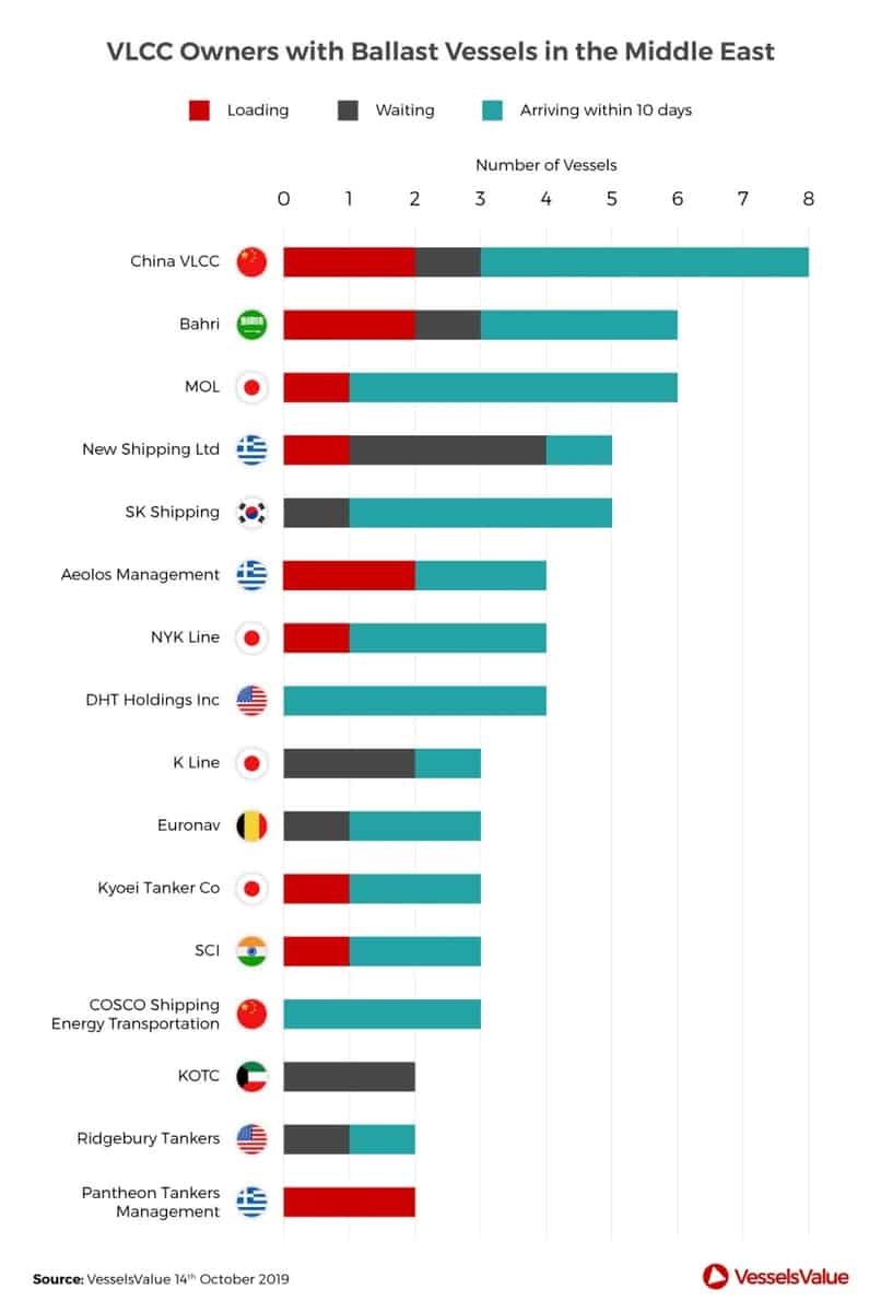

U.K.-based VesselsValue has used vessel-positioning and ownership data to map out exactly which owners have exposure to today’s near-record-level VLCC rates out of the Middle East.
Excluding ships that are already loading, it counts 50 VLCCs either waiting for cargoes in the Middle East or arriving within 10 days, led by China VLCC (one waiting, five arriving), Japan’s MOL (five arriving) and South Korea’s SK Shipping (one waiting, four arriving). Of the U.S.-listed companies, only two are on VesselsValue’s list: DHT (NYSE: DHT), with four arriving, and Euronav (NYSE: EURN), with one waiting, two arriving.
