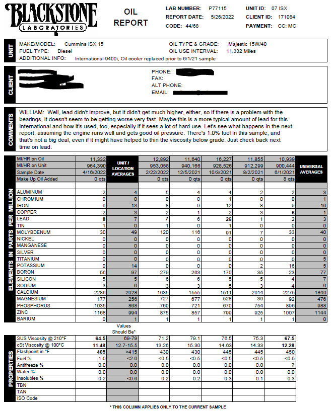

  • Wear Metals – Iron, copper, lead, chromium, aluminum. These tell you what part of the engine is wearing. High iron points to cylinder liners, copper shows bearing wear, lead may signal main bearings, and chromium can mean ring or liner wear.
  • Contaminants – Fuel dilution, coolant, dirt, and water. Fuel in the oil thins viscosity and wrecks lubrication. Coolant points to head gasket leaks or liner issues. Dirt usually signals an air filter problem, which eats cylinders alive.
  • Additives – The sample will also show if the additives in the oil—zinc, calcium, magnesium—are still active. This tells you whether your oil change intervals are realistic.
  • Viscosity – Is the oil still the grade it started as, or has it broken down? Thin oil loses protection, thick oil stresses pumps.
Each report isn’t just a yes or no. It’s a trend line. One high copper reading might be noise. Three samples in a row trending upward? That’s a warning.
(Photo: The Truckers Report: This isn’t just a lab report — it’s an early warning system. High lead levels like these can indicate bearing wear before it shows up on the road. Oil sampling gives you time to fix small problems before they become engine failures.)

Reports usually come back color-coded—green for normal, yellow for caution, red for critical. Don’t panic at one yellow. Look at the pattern. Is copper up one time and back down the next? Or is it climbing sample after sample? Trends matter more than single numbers.
