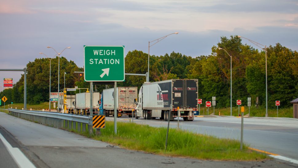

The Commercial Vehicle Safety Alliance’s annual International Roadcheck is scheduled for May 12-14, and this year’s event will zero in on two issues that continue to generate tens of thousands of violations across North America: ELD tampering/falsification and cargo securement. This year, inspectors are going old school.
During the 72-hour enforcement window, CVSA-certified inspectors at weigh stations and pop-up sites across the U.S., Canada, and Mexico will conduct thousands of Level I inspections (meaning a comprehensive 37-step review of both driver qualifications and vehicle mechanical fitness). On average, nearly 15 commercial motor vehicles are inspected every minute during Roadcheck, making it the largest targeted enforcement campaign on commercial vehicles in the world.
