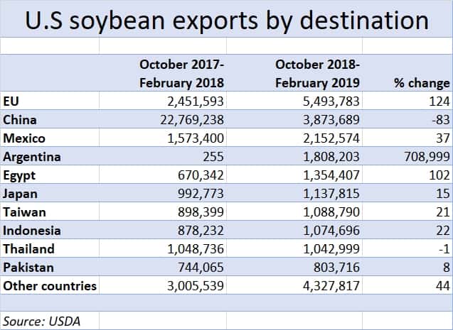

Dry bulk shipping has already felt the pain, and it’s likely to feel more of it. U.S. soybean sales to China have been heavily curtailed since mid-2018, with America’s outbound volumes both reduced and rerouted.
According to data from the U.S. Department of Agriculture, Europe was the largest destination for U.S. soybeans between October 2018 and February 2019, with volume up 124 percent year-on-year to 5.5 million metric tons (mmt). China dropped to second place, with volumes plunging 83 percent, to 3.9 mmt.
Volume to Mexico, now in third place, was up 37 percent, to 2.2 mmt. The fourth-largest destination was Argentina, where volumes rose to 1.8 mmt from almost nothing in the same period the year before. U.S. soybean exports to all destinations fell 31 percent, to 24.2 mmt.
These statistics are particularly ominous when viewed through the prism of ton-miles, because voyages are getting much shorter. The distance from the U.S. Gulf grain terminals to Mexico is minimal; the voyage to Europe is less than half the sailing distance to China; and Argentina is just over half the distance from the U.S. Gulf as China.

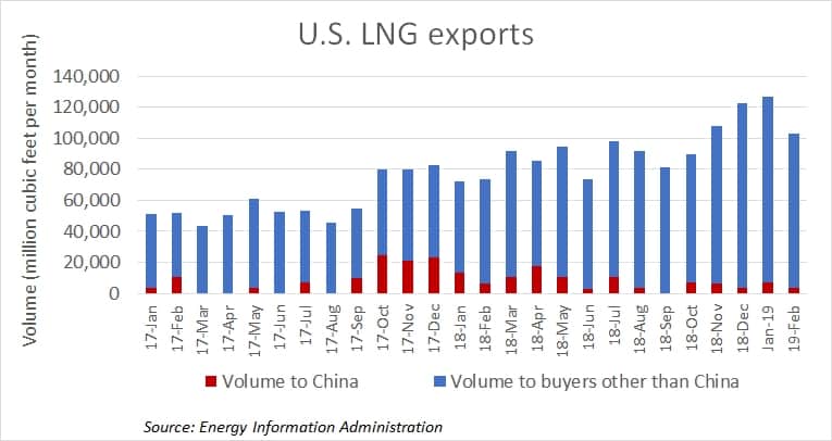

LNG tankers
Given that China is the world’s largest buyer of LNG, trade tensions are widely viewed within LNG circles as a negative.
Multiple U.S. LNG liquefaction (export) projects are now under development. To reach a final investment decision (FID), many of these projects require long-term cargo purchase contracts to enable financing. China’s very limited presence in the U.S. contract market is delaying the timing of U.S. LNG export project FIDs.
The pace of these FIDs is important to shipping because an LNG liquefaction project developer reaching FID usually secures shipping capacity under multi-year employment contracts to move its cargoes. These long-term charters are often used to support funding for newbuildings. The more FIDs, the higher the capacity in the LNG shipping market.
In terms of cargo volume, direct purchasing of U.S. LNG by China has been relatively minimal to date, and U.S. export volumes have continued to surge despite trade tensions.
U.S. LNG export volumes rose 53 percent last year and are expected to rapidly increase in the coming months and years as LNG export facilities that had previously reached FID come onstream, regardless of the outcome of the trade dispute.

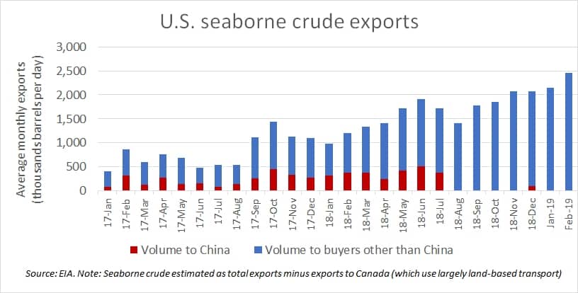

U.S. crude oil had not been targeted with a Chinese tariff as of May 11, but trade tensions have definitely affected the tanker sector. Chinese buyers retreated from U.S. crude purchases last year, and have been almost completely absent from the market since July 2018.
Nevertheless, total U.S. crude exports have continued to hit new peaks, reaching 3 million barrels per day in February 2019, up from 2 million to 2.2 million barrels per day in May-July 2018, when China was a major buyer. Estimated seaborne U.S. crude exports (excluding exports to Canada, which are largely transported over land) have also grown substantially despite China’s withdrawal.
U.S. crude exports to Asia are carried aboard very large crude carriers (VLCCs), which have a capacity of around 300,000 DWT, whereas crude shipped to Atlantic Basin destinations including Europe are largely carried aboard smaller Aframaxes (80,000-119,999 DWT).
China’s pullback has caused the tanker mix for U.S. crude exports to change. There has been some increased buying in Asia that is replacing China-bound VLCC cargoes – to India, South Korea, Singapore and Taiwan – but overall, the destination pendulum has swung more towards Europe, meaning that Aframaxes have benefitted at the expense of VLCCs.
