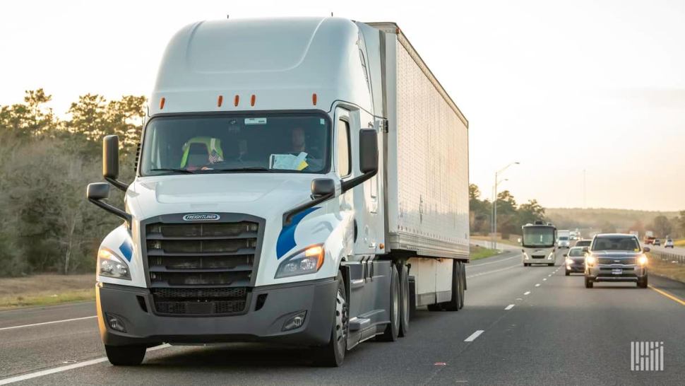

The 2021 and 2022 Freightliner Cascadia is among 15 models being recalled because of a possible tie rod defect. (Photo: Jim Allen/FreightWaves)
