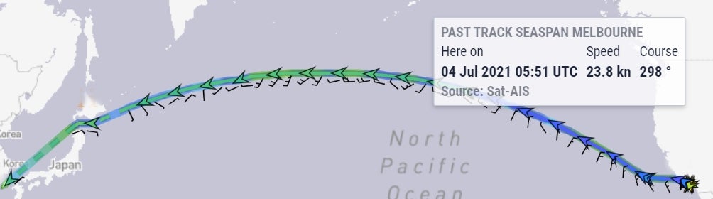

Just one of many examples of container ships recently sailing westbound at 20 knots or more: Automatic Identification System (AIS) vessel-position system data from MarineTraffic shows that the 4,253-twenty-foot equivalent unit (TEU) Seaspan Melbourne hit nearly 24 knots this month in the eastern Pacific on the backhaul from Los Angeles to China.
