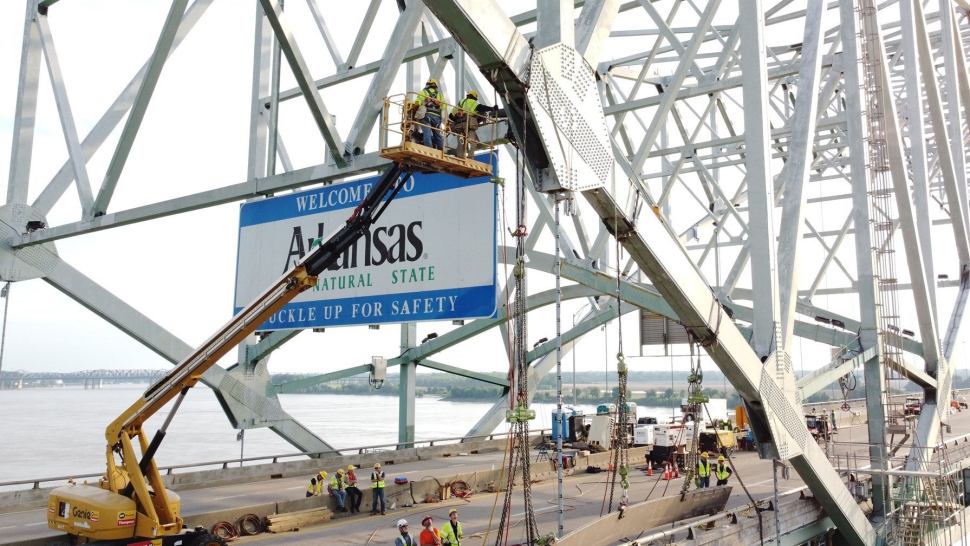

Crew installing steel plates during repairs on the Hernando de Soto bridge on May 22, 2021. (Photo: TDOT)

Next they had to begin installing steel plates on each side of the fracture to secure it. This allowed crews to repair the bridge by working on the bridge deck itself, rather than from on top of barges. This second phase was completed by July 4.
Meanwhile, on June 2, inspection of the bridge commenced. Crews inspected every weld on the bridge using ultrasound so they could see into the welds, ensuring there were no problems. They have found anomalies along the way, had more steel plates fabricated, then bolted them down in these areas. This process was ongoing as of late July.
