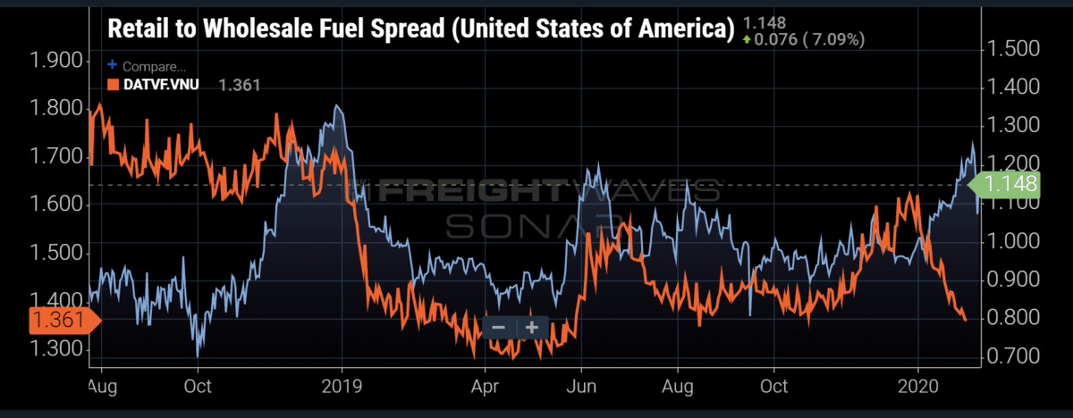

Chart of the Week: Retail to Wholesale Fuel Spread – USA, DAT Longhaul Van Freight Rate – National SONAR:FUELS.USA, DATVF.VNU

Earlier this month, award winning energy market journalist, John Kingston, wrote about why the price has not increased as anticipated. With the domestic trucking market experiencing its typical winter lull as spot rates fall rapidly from the holiday peak, the spread between rack or wholesale price of low sulfur diesel and retail jumped above a $1.20/gal for the first time since January 2019, lowering many carriers’ fuel costs in relation to fuel revenues.
The reason the spread between wholesale and retail diesel price is important for trucking operators is due to the fact many carriers buy fuel off the rack —or at some derivative of the rack price—and charge their customers based on retail price. “Rack” is the term used for the facility where refineries hold the oil prior to distribution, normally picked up by a tanker truck.

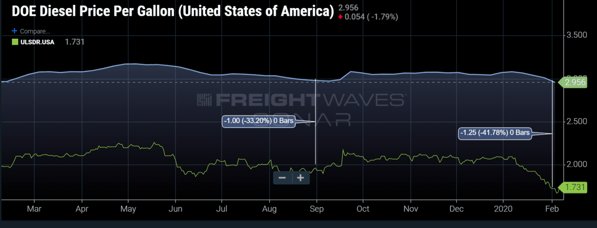

The charge carriers pass along in the form of a fuel surcharge is based on the average retail price in most cases, which is reported by the Department of Energy (DOE) every Monday. When these two values diverge—as they have been doing—carriers get the added benefit in the form of decreased net fuel expense (fuel costs less fuel surcharge revenue).
The rack price of diesel has fallen rapidly in contrast to the retail price this year. The spread between the two numbers impact carrier costs. SONAR – DOE.USA, ULSDR.USA

Truckload carriers normally have a sliding scale that increases or decreases the fuel surcharge for every $0.03 to $0.05/gal movement in the retail price reported by the DOE. Retail prices are slow to adjust to the wholesale price and are far less volatile due to hedging and inventory management by the retail providers.
In other words, the fuel surcharge is sticking at a higher level due to the slow decline of the reported retail average, while those who buy off the rack are getting the benefit of rapidly falling prices—costs are declining faster than revenues.
