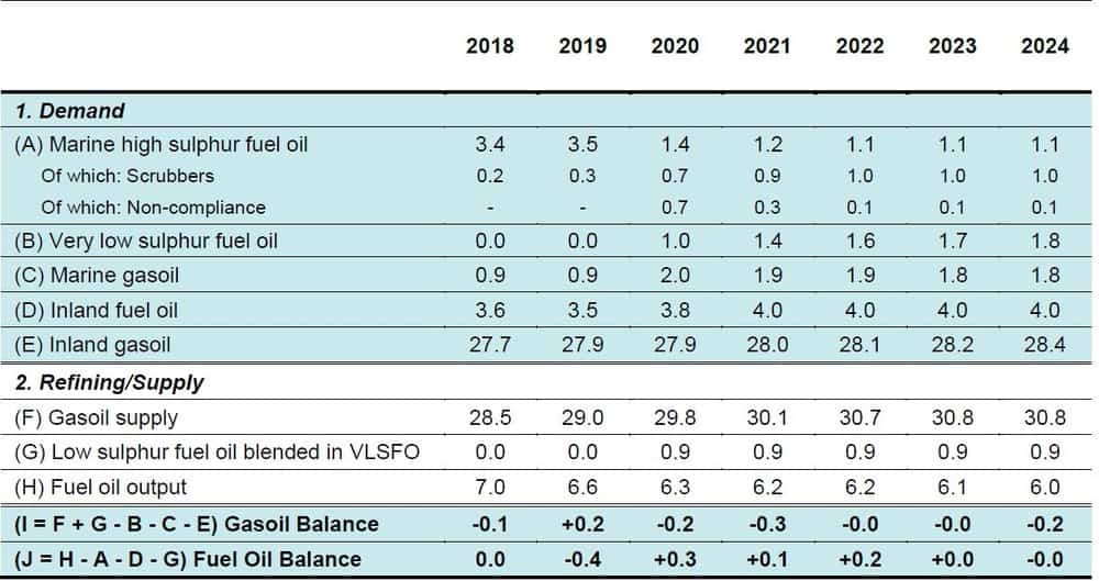

In its recent Oil 2019 report where the 700,000 b/d non-compliance forecast was issued, the IEA also put a number on how much MGO would be consumed to meet the IMO 2020 mandate. The Oil 2019 report’s estimates are probably the clearest so far of the supply/demand balance shifts in the distillate pool as a result of IMO 2020. The report, whose summary numbers are below, spells out the demand for various types of marine fuels, projected out over the first five years of the IMO 2020 mandate, as well as what is happening during the last two years before the rule kicks in.
As the table shows, increased use of distillate fuels in MGO and as a blendstock in VLSFO, when combined with existing uses (such as the category marked “inland gasoil”), will lead to a demand figure in 2020 and 2021 that will result in a gasoil deficit of 200,000 b/d in 2020 and 300,000 b/d in 2021.
 Source: IEA. Figures are in millions of barrels per day
As the report notes, “This is small in the context of the 30 million b/d global gasoil market, although additional investments in new refining units are needed.” But what the model does not envision would be a surge in MGO demand at the beginning of the mandate while the industry gets acquainted with VLSFO.
