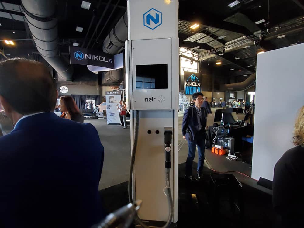

Schneider added that station design includes 8 heavy-duty fueling pumps and 4 light-duty fueling pumps for automobiles, with each station capable of filling 150 trucks and 200 cars per day.

The initial testing will feature pre-commercial 70MPa hydrogen heavy duty vehicle high flow (H70HF) fueling hardware for future Class 8 (40 ton) trucks. The industry group has created specifications for the fueling nozzle, vehicle receptacle, dispenser hose and breakaway device components.

 A Nel Hydrogen fueling pump is displayed during Nikola World 2019 in Scottsdale, Arizona, on April 17, 2019. Nel will build the hydrogen fueling stations for Nikola Motor as it deploys hydrogen-electric powered trucks. ( Photo: Brian Straight/FreightWaves )
