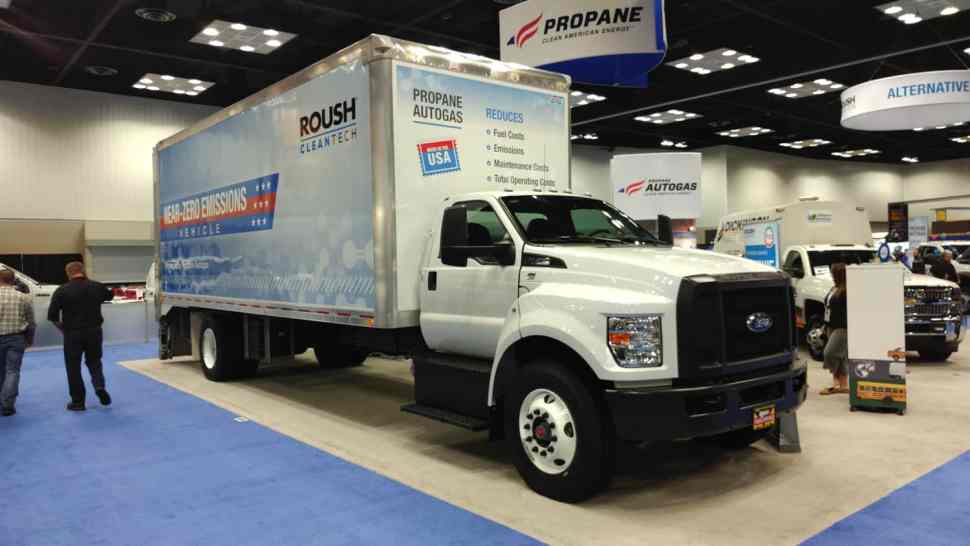

While propane doesn’t pack quite the punch diesel does, it does produce enough power to handle many of the tasks at a fraction of the overall cost, advocates say, up to Class 7 applications as this Ford F-650 box truck shows, so why is not a more popular fuel for commercial operations? ( Photo: Brian Straight/FreightWaves )
Strolling the floor at the National Truck Equipment Association’s Work Truck Show in Indianapolis last week, one booth had a large baby blue box van in it. Among the rest of the displays in the booth, this truck, built on the Ford (NYSE: F) F-750 truck platform, was powered by propane (sometimes called autogas) in a system developed by Roush CleanTech. The truck generated a broader question – “Why don’t more fleets use propane as a transportation fuel?”

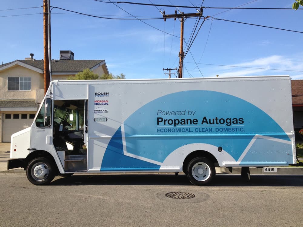

 One of the benefits of propane is that it is a flexible fuel that can power vehicles from Class 1 cars and pickups, through lower-weight Class 8 vehicles. This is a propane-powered delivery van on a Ford F-59 stripped chassis with Morgan Olson body. ( Photo: Roush CleanTech )
