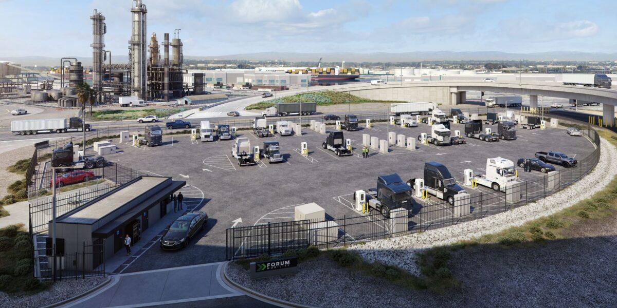

Forum on Thursday announced a 9-megawatt charging depot at California’s Port of Long Beach. The facility adjacent to the Long Beach Container Terminal. will require as much power as a large sports facility. Forum expects energy flowing to the site will be capable of charging more than 200 trucks a day by the third quarter of 2024.
A rendering of Forum Mobility’s 9-megawatt charging facility that will open in late 2024. (Image: Forum Mobility)
Simultaneous charging for 44 trucks
The Long Beach charging depot will offer 19 dual-port 360-kilowatt chargers and six 360-kW single-dispenser chargers. They will be able to charge 44 trucks at the same time with the ability to charge an electric Class 8 truck in about 90 minutes depending on battery size.

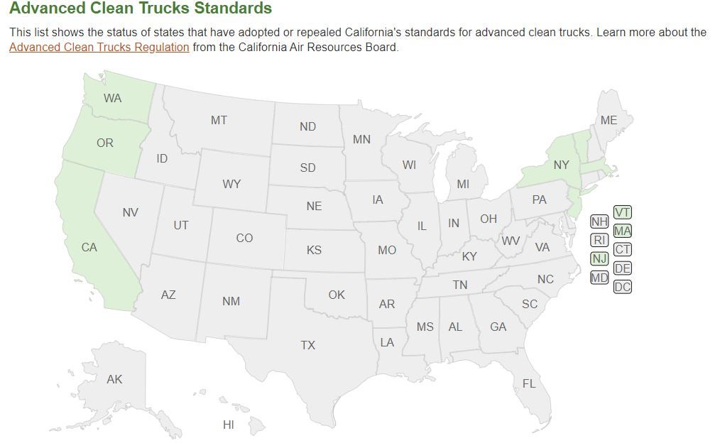

Seven states — Oregon, Washington, Colorado, New York, Massachusetts, New Jersey and Vermont — have adopted the California rules. Several others are considering signing on.
The map shows states that have adopted California’s Advanced Clean Trucks rule. Colorado also has adopted the standards. (Source: U.S. Department of Energy)
