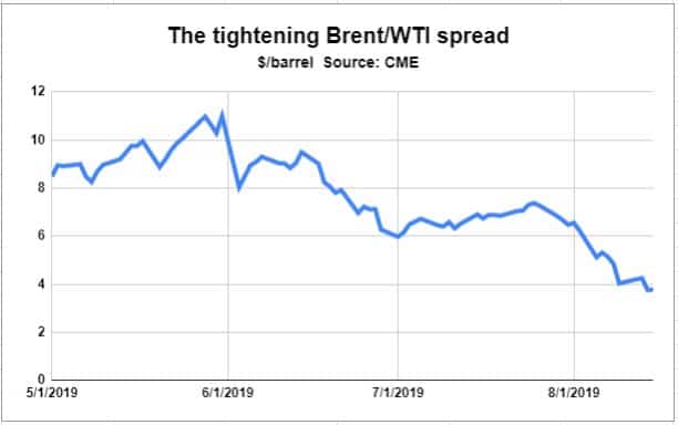

Even though these lines have been planned for some time, the market is starting to take notice. Between January 1 and June 30, the Brent/WTI spread averaged $8.69. From July 1 through August 16, it was $6.09. For August so far, it is $4.83. And for the last two days of trading, it was less than $4.00.
Firm data on the cost of moving crude oil by rail is somewhat less than transparent. A general consensus seems to be that a $10 difference exists between moving crude via rail rather than pipeline. It is clearly more complicated than that; if it was a simple $10, none would have moved earlier this year when the spread was at $8. But can any of it move at a spread less than $4?
