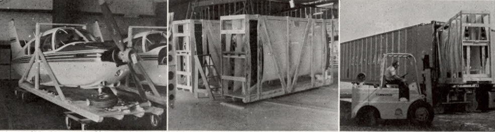

In the course of analyzing its container requirements, Piper had determined it needed a high cube, closed-top 40-footer. This would permit it to pack and ship two complete aircraft (with the wings detached) to its distributors in Europe.

“We would disassemble our aircraft, skid the fuselage on a wooden skid, crate the wings, placing one fuselage and once wing side-by-side in a container. Then we would reverse the position of the second unit, utilizing the tapered fuselage so both units would fit in the 40-foot container. It meant that we had to drill 38 holes through the skids and floor of the container to properly secure the units for shipment.

Said McCollum, “Because we had fastened the unit in the container by putting the nut on the bottom of the outside of the container floor, there was no way to unfasten the units within the container. Their telex said: ‘Run bolts from bottom up, put nut on top and we will be able to handle and release the shipment with ease.’”
