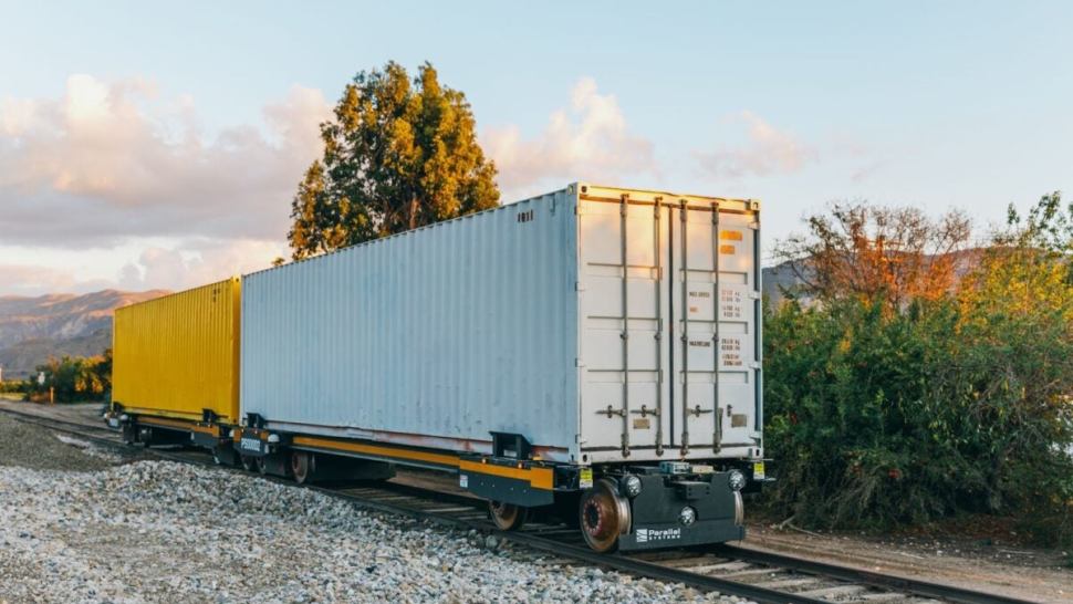

Parallel’s prototype flatcar can carry one intermodal container 500 miles on a single battery charge. The batteries in each truck power the car’s traction motors. The autonomous system relies on cameras and sensors, as well as software in computers on board the car and at a data center. Electronic brakes can bring cars to a stop in one-tenth the distance of conventional equipment with air brakes.
The approval grants Parallel, Georgia Central and Heart of Georgia railroads 22 waivers from car and locomotive regulations that cover everything from cabs and sanders to brake valves and uncoupling levers. The decision includes 23 conditions that Parallel and the railroads must follow during the pilot program.

Parallel’s battery-electric cars — which can run alone or together as an autonomous platoon of up to 50 cars — can each carry a single container. They can operate at up to 25 mph and tackle grades as steep as 3%. They’re also undergoing testing in Australia.
“These design features are intended to help railroads better compete against trucks in the short-haul movement of intermodal containers rather than to replace conventional railroad rolling stock,” the application says.
The tests aim to evaluate the three primary components of the Parallel system: the autonomous vehicles themselves, the user terminals that allow people to control the equipment, and the computer servers that send data between the vehicles and the user terminals.
