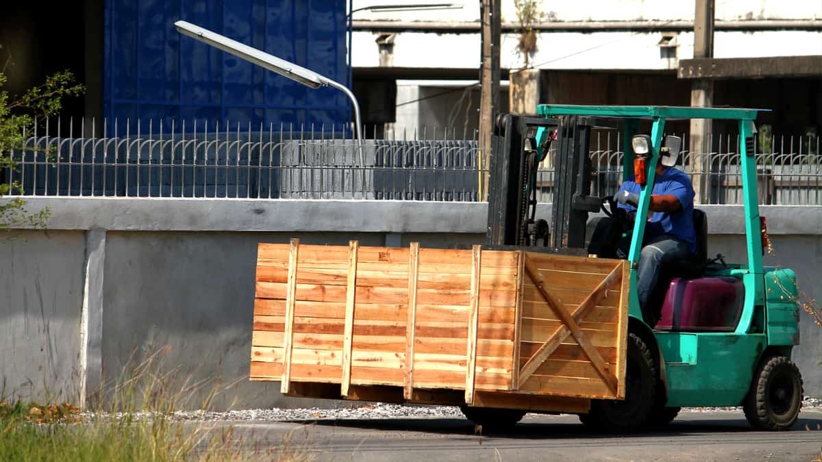

4. Consider specialty packaging
When measuring the dimensions of your item, wait until it’s completely wrapped and packaged. If you measure the item before you pack it, you’ll likely come up with the wrong weight and dimensions.
Choose the right type of packaging to prevent damage to machinery. In some cases, specialty packaging – such as shrink wrap, vacuum and shock mount packaging – may also change the freight code of your item.
