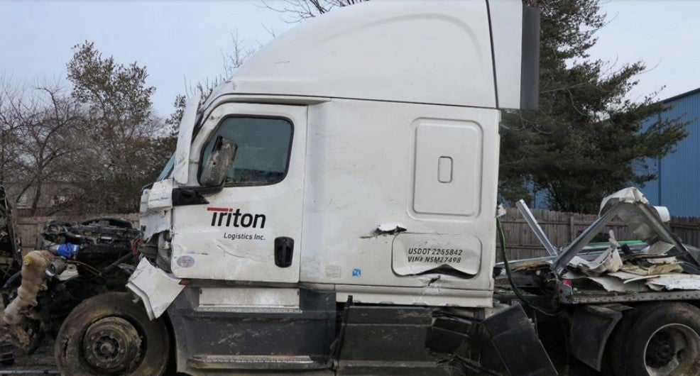

Truck cab involved in accident post-crash. Credit: NTSB
