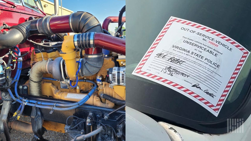

When an inspector places a vehicle or driver out of service, the carrier has 15 days to sign the inspection report certifying all violations have been corrected and return it to the issuing agency. They must keep a copy for 12 months.
Sounds reasonable, except CVSA recently petitioned FMCSA to eliminate the return requirement entirely, calling it “antiquated and redundant.” The inspectors’ own alliance is asking the agency to stop requiring carriers to confirm they fixed the problems.
FMCSA doesn’t have data on how many agencies actually request these forms. The agency admitted it can’t quantify the impact of eliminating the requirement. They’re proposing to make it optional based on whether individual states want to bother.
The proposed rule landed in May 2025. If it passes, we’ll have an out-of-service system with no verification mechanism whatsoever.
