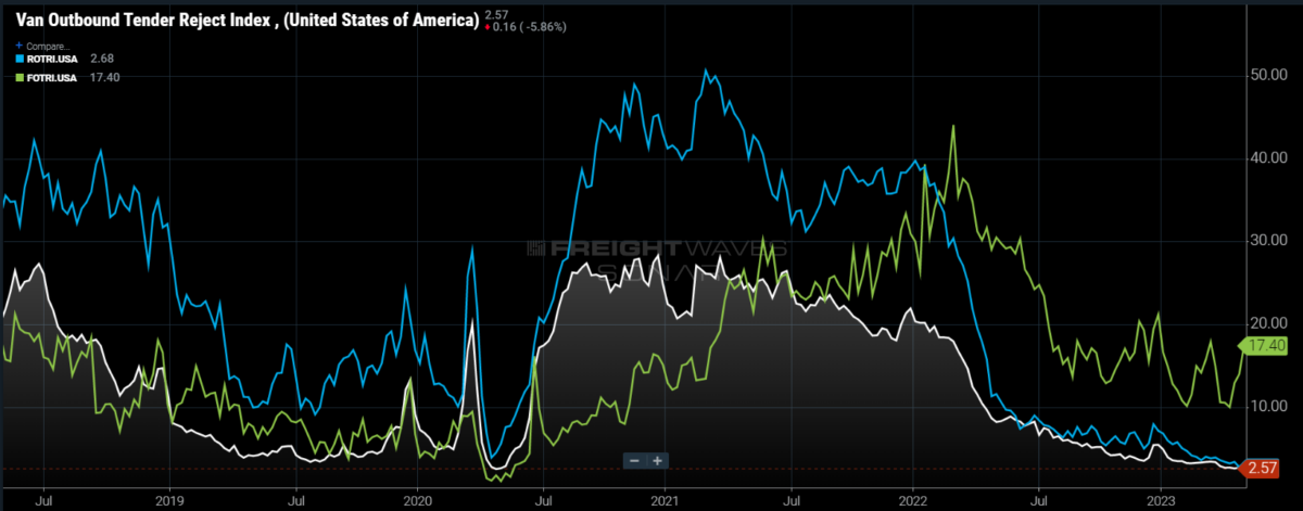

Flatbed capacity continues to be challenging to source over a year after the truckload market collapsed for dry van and refrigerated freight. Tender rejection rates, the percentage of loads carriers are unable to cover for their customers, have moved below 3% for van (VOTRI) and refrigerated or reefer (ROTRI) loads while flatbed rejection rates jumped back over 17% this past week. Why is flatbed capacity not following in trend with the other two trailer types?

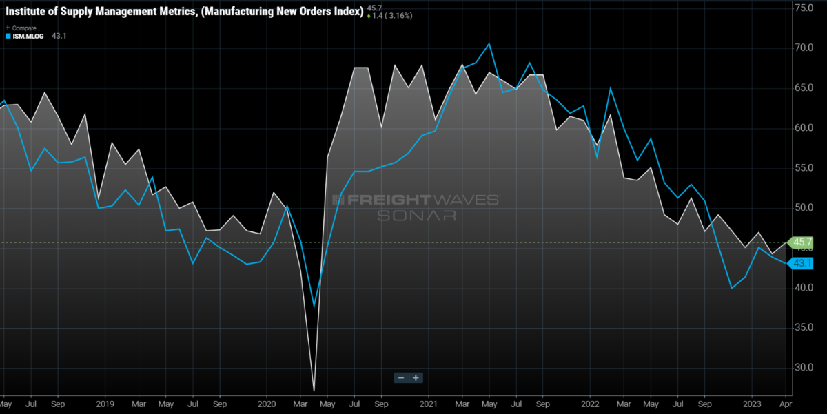

The new orders component of the Institute for Supply Management (ISM) indices illustrates how new orders — a leading indicator for freight — were coming in at all-time highs from July 2020 till Q3 2021. Subsequently backlogs of orders expanded at nearly an identical pace throughout 2021.

Flatbed rejection rates were well below van and refrigerated for most of the second half of 2020 and first half of 2021, a very unusual situation from a historical context. Flatbed capacity tends to be as erratic as its demand, making it harder to secure in general. Van spot rates rarely exceed flatbed for this reason. Flatbed freight also tends to be more labor-intensive and specialized.

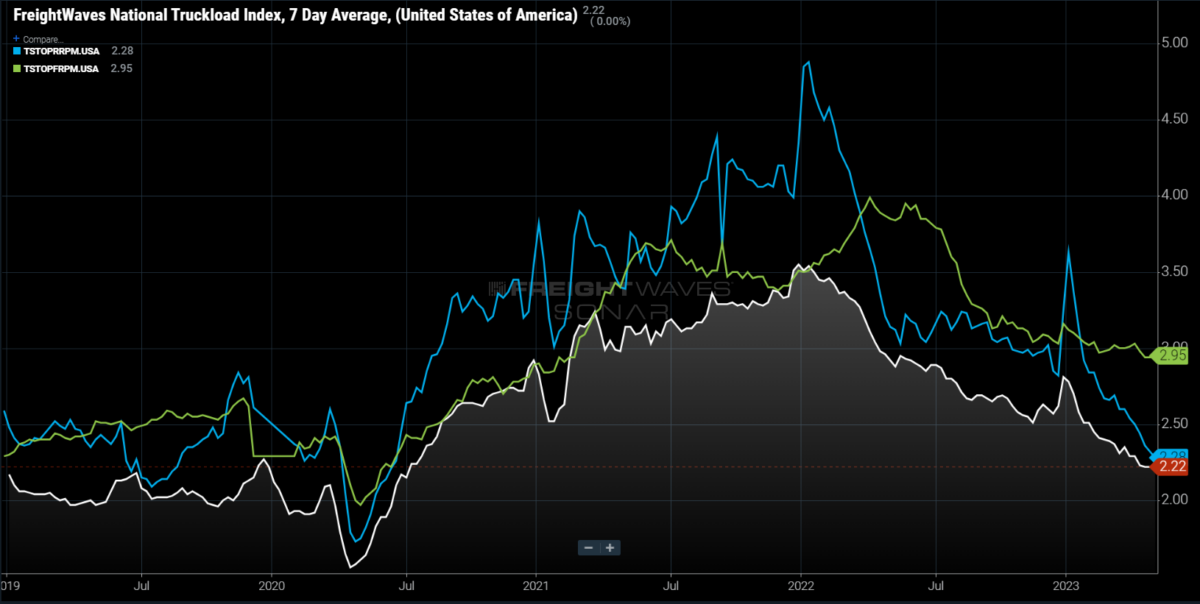

With rates for general dry van freight (white) being in line with flatbed (green) during the heart of the pandemic in 2021, it possibly helped limit capacity growth for this equipment type. This would be a lot like the seasonal effect described above but on a larger scale.

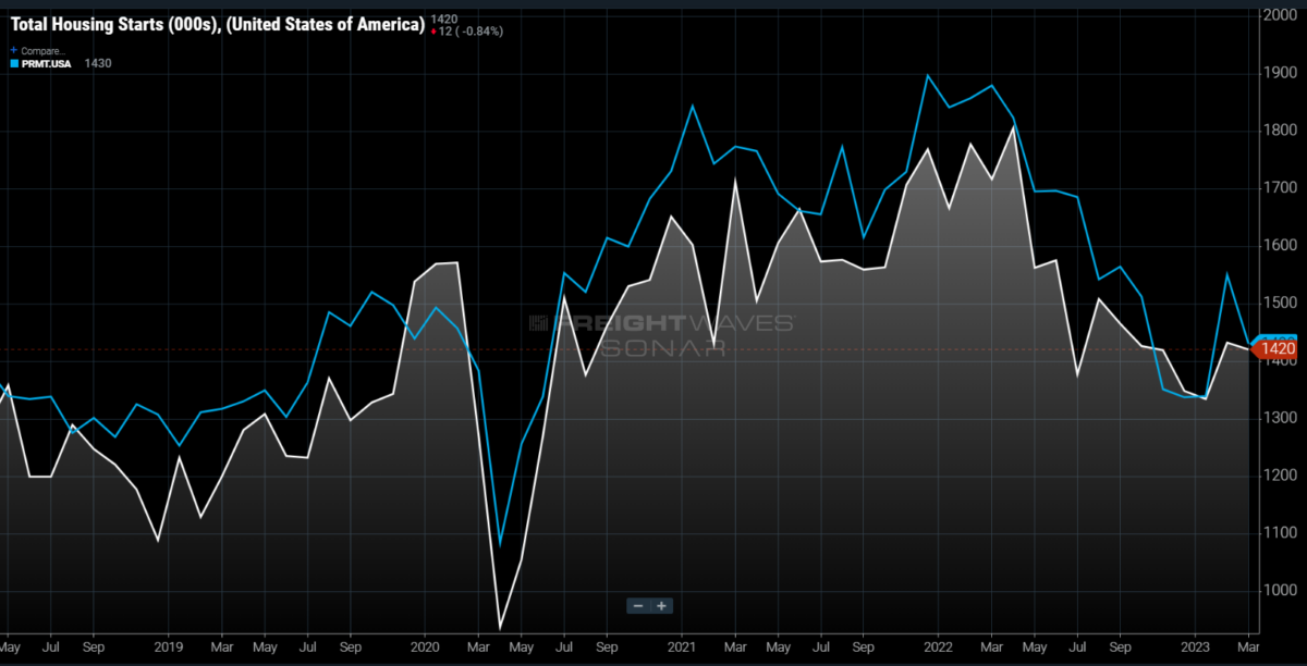

The economy is still slowing. Real GDP growth only hit 1.6% this past quarter, with goods-adjusted GDP only reaching 0.62%. Housing starts and building permits are contracting from highs hit in early 2022.
