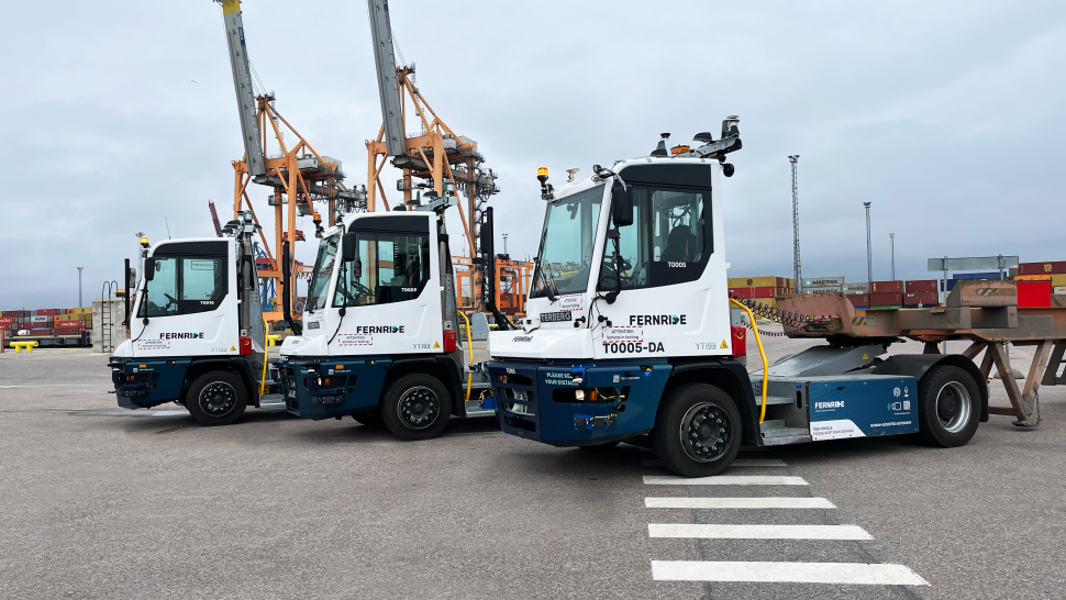

Fernride has become the first European company to operate terminal tractors without safety drivers while generating commercial revenue. The autonomous yard deployment is in the Estonian seaport of Muuga at HHLA TK Estonia terminal near Tallinn, Estonia’s capital.
The milestone came after the company received TÜV SÜD certification under the EU Machinery Directive and approval from the Estonian Transport Administration.

Unlike U.S. autonomous trucking operations that still use safety drivers, Fernride’s system operates with no personnel in the vehicle cabin. Instead, the company employs a 1:4 ratio model where one remote operator monitors four autonomous trucks simultaneously, intervening only when necessary.

The system’s design includes continuous over-the-air updates, with AI learning from edge cases encountered during operations. Remote operators can issue simple commands or take full remote control during unusual situations, such as when a bird blocks the truck’s path. Kramer noted that the remote operators are driver managers, not safety drivers in the traditional sense, since there are no drivers in the cab.
Fernride’s technology is powertrain-agnostic, supporting both diesel and electric vehicles through retrofitting existing tractors. The Estonian terminal tractors are diesel but Kramer added, “We also have tractors with EV. Both options exist in the market. We can also retrofit the system into existing tractors. So we want to stay quite agnostic to the powertrain and what kind of tractor decisions are made by the customers.”
The company monetizes its technology through an annual software-as-a-service subscription model, with plans to improve operator-to-vehicle ratios to 1:6 next year and 1:8 by 2027. The company currently operates three trucks with one remote driver manager. Over the next year, the company is looking to expand to two driver managers for six vehicles and 24/7 operations.
