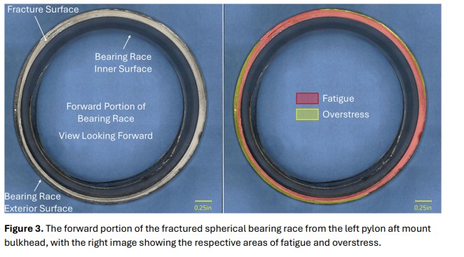

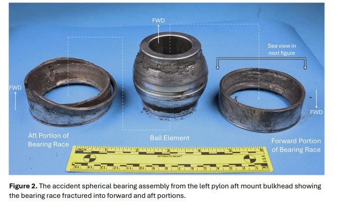

The engine and pylon separated from the wing of the UPS MD-11 as it lifted off from Louisville airport, igniting a fire and sending the plane into a closeby industrial park. Fourteen people died in the crash, including the three pilots. A National Transportation Safety Board investigation is focusing on fatigue cracks in the pylon bulkhead’s aft lug nut, according to a preliminary report soon after the Flight 2976 accident. The lug and the metal ring housing the section’s roller bearings were fractured. When the ball ring cracks, the ball elements naturally spread the halves of the forward and aft lugs.
The aft lug is subject to high tension because it balances engine torque, weight and variations in engine thrust, acting as a force stabilizer.
Boeing warned MD-11 operators in 2011 about a broken engine attachment but never flagged the failure as critical to flight safety, the NTSB said in January. Boeing issued a service bulletin that identified four previous separations of a spherical bearing assembly that helps hold the engine to the MD-11’s wing. The manufacturer said two sections of the assembly came loose on three different aircraft. The letter advised airlines to conduct visual inspections of the part at 72-month intervals.
(Source: NTSB preliminary report on UPS Flight 2976 accident.)

Technicians inspecting FedEx planes found no bearing or lug problems. Sixteen bearings have been removed so far. In one case the beginning of separation in the bearing was noticed, but they caught it at an early stage — before there were any cracks. Within a week of the UPS accident, FedEx’s engineering team shared detailed maintenance records and inspection data with Boeing. Since then, some members have spent the past four months at Boeing’s manufacturing site in Seattle, technical operations managers said during the presentation.
The company has also shared data, lessons learned and best practices with the FAA and other operators of the MD-11.
In November, quality control and engineering teams developed an additional layer of testing using newly designed probes to conduct ultrasonic testing that can provide an even earlier indication of fatigue in the inner surfaces of the bearing and outer ring.
The critical safety analysis relied on the original certification data for the aircraft that McDonnell Douglas designed and that Boeing now owns, as well as updated modeling and analysis based on FedEx’s detailed fleet maintenance history. Boeing validated load tests on the bearings using a die penetrant inspection to confirm there were no cracks.
Eventually, Boeing engineers determined that if they could keep the bearing from fracturing the pylon assembly was safe. They changed the design to remove a lubrication groove that created extra stress and made the outer edge of the ring thicker
Although FedEx planes with 24,000 cycles — takeoffs and landings — had no visible safety issues, the company will now replace the bearing every 4,000 cycles as part of Boeing’s new repair procedure, with an inspection procedure performed every 450 cycles, said Josh Canfield, senior vice president of tech ops. The process will involve an eddy current inspection, which uses electromagnetic induction to detect surface and near-surface flaws in conductive materials, and ultrasonic inspection
