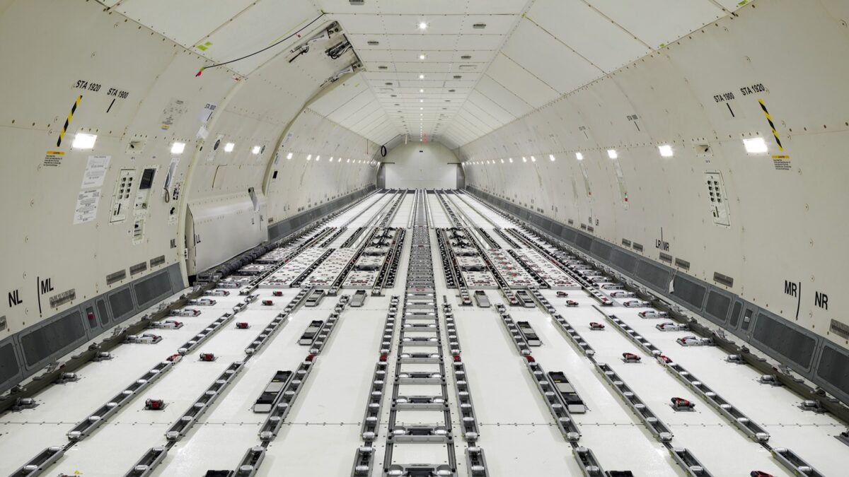

Mammoth Freighters has spent more than six years developing its conversion system for the 777. The conversion process includes installing a wide cargo door, reinforced flooring, a rigid 9G barrier in front of the cockpit, main-deck temperature controls and a cargo handling system system for maneuvering large pallets. Reconfiguring a large aircraft like a 777 takes about six to eight months. Once a steady state is achieved in its production lines, Mammoth anticipates being able to complete conversions in under six months as installation methods and process matures, said Brian McCarthy, the company’s vice president of marketing and sales.
The Boeing 777-200 converted freighter has a massive cargo hold on the main deck, where passenger seats used to be. (Photo Mammoth Freighters)
