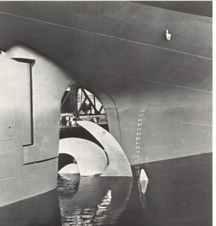

The sister ships Ultramar and Ultrasea are as similar as two peas in a pod until you look closely at their sterns.
There, tucked out of ordinary view beneath the fantail and behind the rudder, the Ultrasea displays a sharply pointed propeller which bears more resemblance to a set of cowboy spurs than it does to the fulsome curves associated with most ship propellers — including that of Ultramar.
The wheel on the Ultrasea does, in fact, spur the ship along at a speed one knot faster (at 950 RPMs) than the Ultramar and saves the operator as much as $250,000 a year in fuel costs to boot.
Furthermore, the new propeller — officially described as “highly skewed propeller” — does its job with such quiet perfection that vibrations aboard ship are reduced to a surprising minimum. This point was all the more surprising to the crew when the ship arrived at Galveston last fall and personnel ashore reported one blade of the propeller was broken and missing. With any other propeller, the crew would have known the instant the mishap occurred and would have endured the vibrating misery of the missing blade until the voyage was completed. The ship itself would have suffered and finely calibrated instruments would have been shaken out of adjustment, fittings loosened, and shaft and engine parts worn down before their time.
The Ultrasea and Ultramar are “test tubes” in a large-scale experiment undertaken by naval architects, marine engineers and the Maritime Administration to improve operating efficiency of ships. MaRad has yet to report its formal conclusions, but there can be little doubt when one spends a few minutes talking with men aboard the ships and officials of the company who operate them.

One of the propeller’s blades broke during the trip but did not affect the voyage. (Photo: American Shipper)
One experimental method of reducing the problem is the highly skewed propeller which reduces cavitation and vibration by equalizing the forces acting on the propeller.

As evidence to possible savings, before the Ultrasea was put into service, one blade on her highly skewed propeller was damaged and restored by the electrical conduction method. This method, which weakens the blade, is not practical on a conventional propeller because the normal cavitation would cause the blade to break almost immediately.
The blade finally broke on the vessel’s last voyage before being laid up but according to Peter Constans, vice president of Aires Shipping, the vessel’s crew was unaware the blade was broken until they reached port and there was no noticeable decrease in operating efficiency with half of one blade gone as there would have been if the blade were equipped with a conventional propeller. According to Constans, the highly skewed propeller is performing much better than the conventional propeller.

Of the skewed propeller, Captain James D. Bennett aboard the Ultrasea said, “It’s a real fancy blade. The thing that is amazing is that the propeller’s been damaged and one-half of one blade is missing and I can see no change in the performance. We can not detect any change in the vibrations in the ship as far as the shaft and what have you is concerned.”
Captain Bennett said that even though they knew the blade was broken somewhere between Hamburg, Germany, and Galveston, Texas, on their last voyage, they do not know where because the break was not discovered until they reached Galveston.
