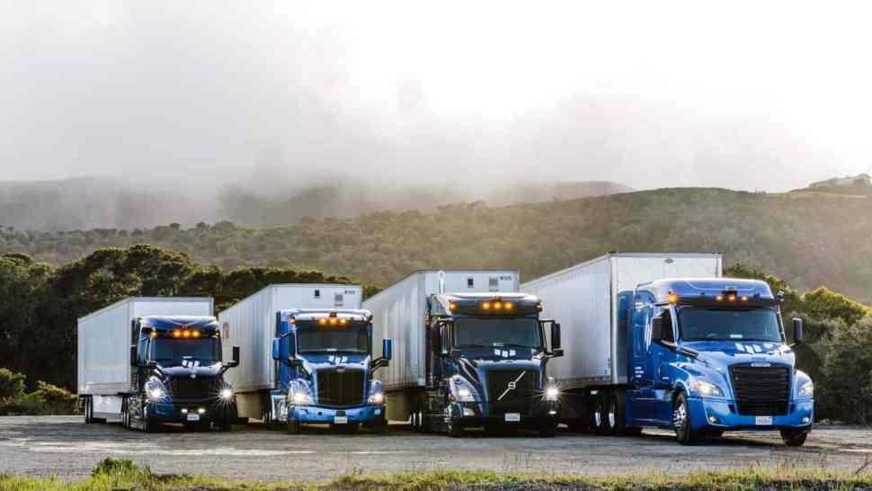

Embark Trucks has developed a common interface that allows autonomous trucking technology to plug and play among a variety of models. (Photo: Embark Trucks)
Self-driving truck startup Embark Trucks Inc. has developed a plug-and-play autonomous trucking software package. It will work on Freightliner, Volvo, Peterbilt and International trucks.
