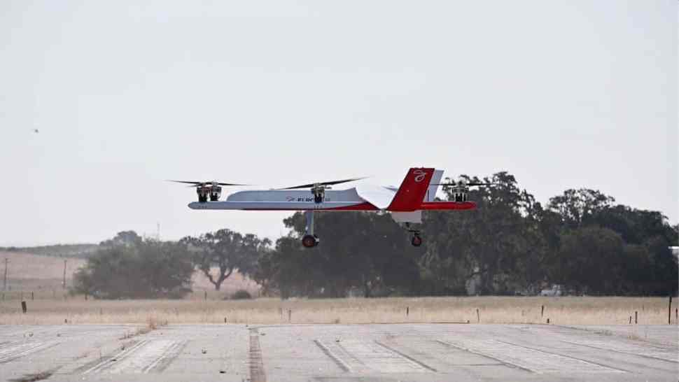

San Francisco-based aerospace and logistics company Elroy Air has announced that it has completed its first full-scale system flight test, with the 1215-pound prototype hovering in the air for 64 seconds at the height of 10 feet, before a safe descent and landing procedure.

The test was the first phase of Elroy Air’s flight testing, with this phase intending to prove the vertical flight performance characteristics of takeoff, hovering and landing. Phase two will be about transitioning onto a wing-based flight and the aircraft’s ability to take up long-range missions.
“What we’ve achieved in this first phase is a validation of major parts of the technology stack that we’ve been developing here internally. The vertical flight mode involves the six large brushless motors, motor controllers, battery system and the autopilot, which is responsible for stability and vertical flight,” said Merrill.
Though the test looks to be simple on the surface, it represents the working of a set of sophisticated subsystems in tandem and enabling the first mode of flight. This process is critical to the aircraft’s overall functioning, and this test validates the takeoff and landing portions of all the eventual Elroy Air missions.
