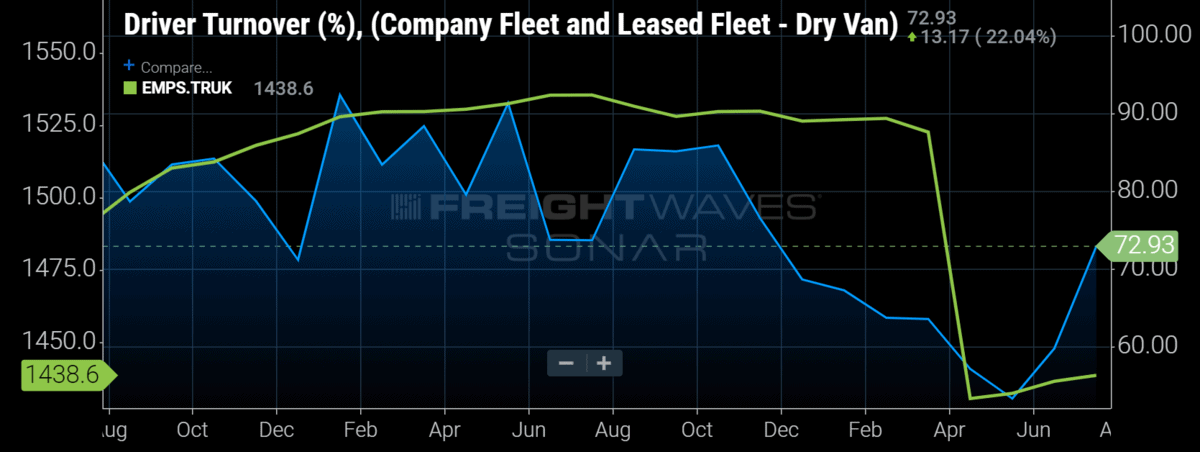

Chart of the Week:  Driver Turnover – Company and Leased Fleet, Employment Levels – Trucking Sector SONAR: DRVTO.VCFOO, EMPS.TRUK

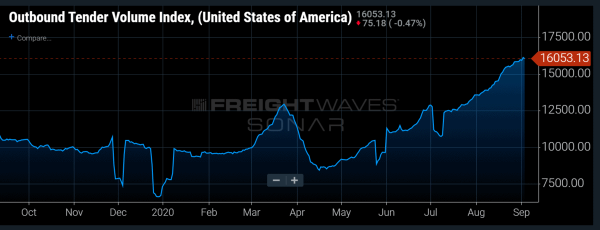

Truckload volumes recovered much faster than expected. Chart: SONAR – OTVI.USA
The slow employment recovery is vastly divergent from trucking volumes. Overall trucking volumes have recovered beyond previous-year levels. Accepted tender volumes were 18% higher than last year on Aug. 31, according to FreightWaves tender data. In other words, carriers are doing more with less.
The Truckload Carriers Association (TCA) reports its dry van members saw a sharp increase in driver turnover in July from June — driver turnover increased from  61.5% to 76.06%. This was the largest single-month jump since January 2019. TCA members reported a driver turnover rate of 80.7% at the end of July 2019.
Turnover percent is a measure of how fast you lose and replace your employees. A driver  turnover rate of 76% means that over three-fourth of your drivers quit or are terminated each year and are replaced. Truck drivers have a notoriously high turnover rate, with many midsize and larger carriers seeing turnover rates above 100% — something unheard of in many industries.
Turnover rates are a function of economic options. If there are abundant jobs available, turnover rates tend to increase. Driver turnover dropped to 55.8% in April when the economy shut down but has recovered quickly — an indication that options have as well.

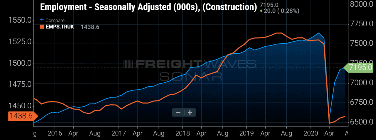

Construction employment levels are recovering at a faster clip than the trucking sector. Chart: SONAR EMPS.CONS, EMPS.TRUK
The concern for carriers will be in whether or not drivers will be permanently leaving the space for other sectors. One of the main competing sectors for drivers is construction. Since April, construction employment levels have increased 10% compared to trucking’s 0.5%. Like transportation, construction was not hit as hard by the COVID-19 outbreak and subsequent economic shuttering and in many cases did not feel the initial hit at all as their jobs are already socially distant.
