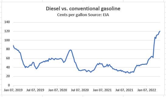

Just how much has that spread widened? The accompanying chart shows the spread between retail gasoline and retail diesel, according to the average price published each Monday by the EIA.
For the diesel-consuming industry, this price isn’t some abstract figure popped out by the government; it’s the basis for most fuel surcharges. A year ago, that spread was just under 40 cents a gallon. Based on the most recent prices published Monday, the spread is now about $1.20 a gallon.

The spread crossed the $1-a-gallon mark on March 18. At the start of 2022, it was about 47 cents. For all of 2021, the spread averaged less than 40 cents. (Brent is the preferred benchmark for comparison because it is the global crude benchmark and diesel is traded globally as well.)
