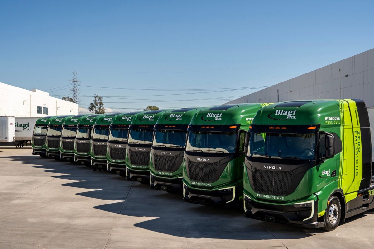

Longtime Nikola supporter Biagi Brothers took 10 for operations in Southern California. It hopes to apply some of its remaining 10 vouchers to add five or six more by the end of the year.
“We wanted to get in on the incentive funds,” Gregg Stumbaugh, Biagi corporate equipment director, told me. “With the $240,000 grants from California, the truck ends up being cheaper than a diesel.”
Biagi is a longtime third-party dedicated freight hauler for Anheuser-Busch with 90-100 Class 8 day cabs serving the beverage maker.
Biagi Brothers took delivery of 10 Nikola fuel cell electric trucks it is using for third-party hauling for Anheuser-Busch. (Photo: Nikola)
Crushed aluminum cargo
The 10 Nikola fuel cell trucks each haul 9,000 pounds of empty beer cans . They travel 145 miles from Ontario, California, to Anheuser-Busch’s Van Nuys production facility several times a day. Like the Frito-Lay snacks cubing out trailers hauled by Tesla battery-electric Semi trucks, Biagi is starting with light loads for the fuel cell trucks.
Why not haul beer?
“We’ve loaded the truck with beer — 81,600 pounds — and driven over the [Interstate 5] Grapevine. We have to be selective on what applications we use it for,” Stumbaugh said.
Biagi helped test the road worthiness during development of the Nikola fuel cell electric vehicle (FCEV). It ran two-truck pilots in 2022 and 2023. They have plenty of oomph. But the roughly 25,000-pound weight of the tractor, a 13,000-pound trailer and 9,000 pounds of empties is enough for now. A typical load of beer weighs in at 47,000 pounds. The math doesn’t work.
“Two things have to happen,” Stumbaugh said. “The truck has to get lighter or the weight allowance has to go up to at least 85,000 pounds.” Since neither is likely soon, the beer loads will move on the 22 diesel trucks Biagi deploys out of Van Nuys.

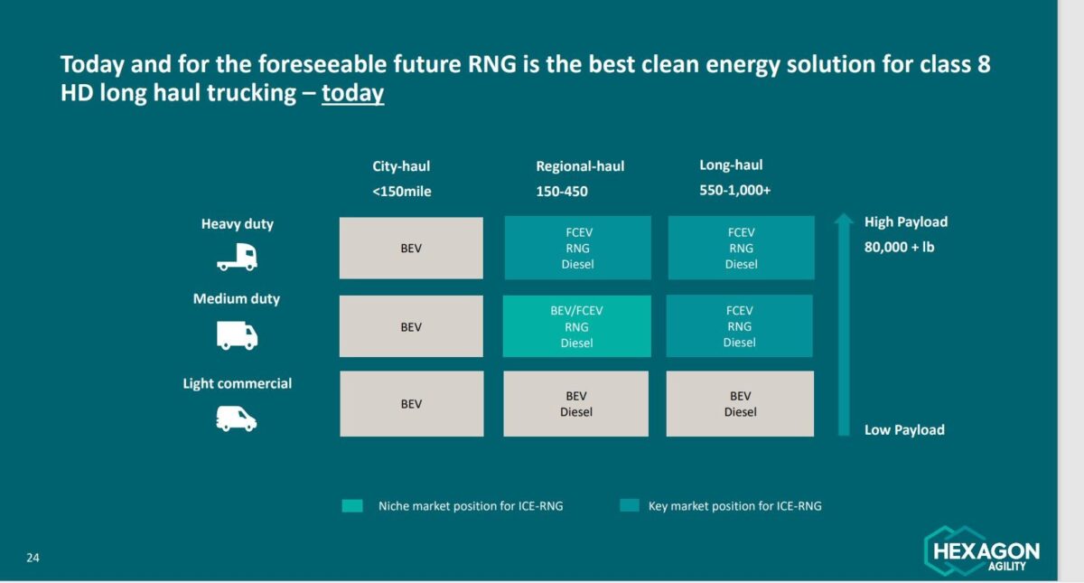

Biagi is quoting an order of 10 trucks with regular production of  the Cummins X15N natural gas engine by midyear. Kenworth delivered the first X15N-equipped T680 on Feb. 20 to UPS, a longtime CNG user.
Running on renewable natural gas (RNG), smog-forming nitrogen oxide emissions should fall below expected Environmental Protection Agency standards set to take effect in 2027, according to Greg Bippus, executive vice president of sales and systems development at natural gas tank and system developer Hexagon Agility.
Alternative powertrains and fuels have best use cases, according to Hexagon Agility. (Chart: Hexagon Agility)
Diesel trucks will need a second after-treatment system to meet the proposed standards, he said.
